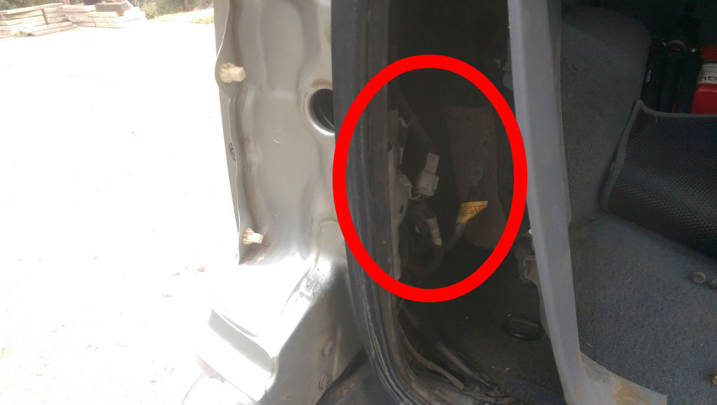

Where was that ground? Post pictures so people reading this thread can benefit!
This isn't the picture of my 4Runner, as I didn't snap any pictures of it. (Had about 30 minutes to get it fixed) I did, however, find a picture of what I was talking about. The picture shows where the ground can be found, and there's even a loose terminal in the picture in the same location as the one I had found. I believe the loose ground in the picture is for installing a trailer plug. The loose one I found was in the same location, just not bolted onto the body.
