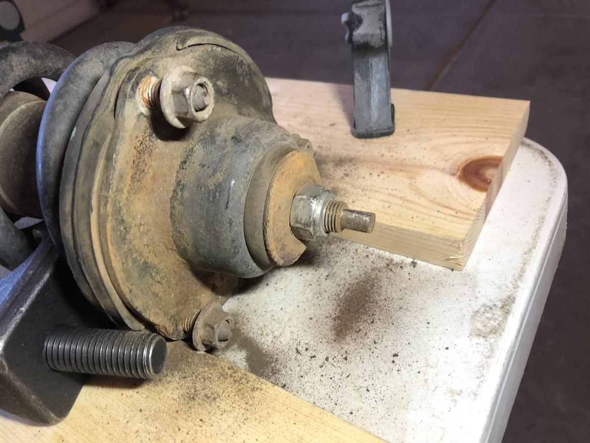

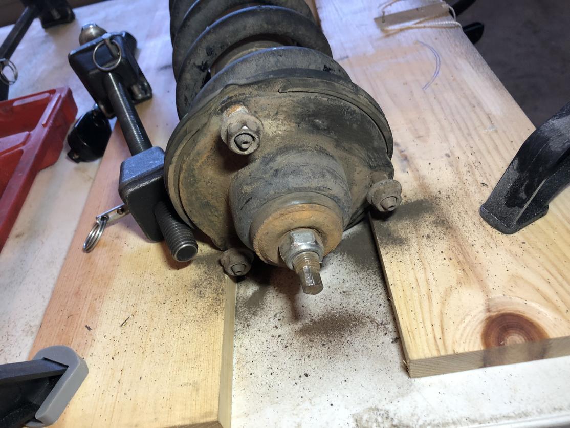

Here are some pictures.
Any favorite lube you've used? Or just WD-40?

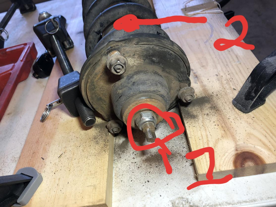

Forgive my crude picture. But put impact at #1 and voice grips on the shaft at #2 between the spring coils. Usethe work bench to hold the vice grips.

No, compress it first. Once you compress it enough that it is loose from the top hat and you can tell all the pressure is off. Once you do that there will still be room to grab the shaft with the vise grips. Then hit it with the impact.

1 - Compress the springs so there is no pressure on the nut you want to remove. Be safe.
2 - Try removing the nut with an impact. Use a 6-pt socket. If that doesn't work:
3 - Hold the top of the strut with a vise grip or a vise and then use a good wrench on the nut (suggest a 6-point rather than 12-point; definitely don't use a crescent)
If you try to remove the bolt while the springs aren't compressed, you may lose an eye.
That whole setup looks like it's seen many salty winters. I would still suggest heating gently, followed by a good lube soak and another heating, before trying to remove that bolt. I like PB blaster but anything should be good. It will delay you a day or even just a few hours, but it looks like that bolt is already being stripped. If you strip it too much further, you may have to grind it off, which will be hard to do without damaging the strut.

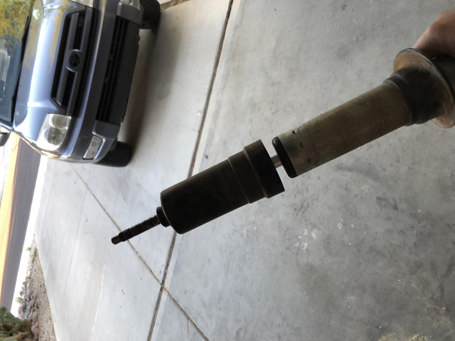

Victorious on the first one! And with all 10 fingers!
Hopefully the second one is not nearly that difficult
