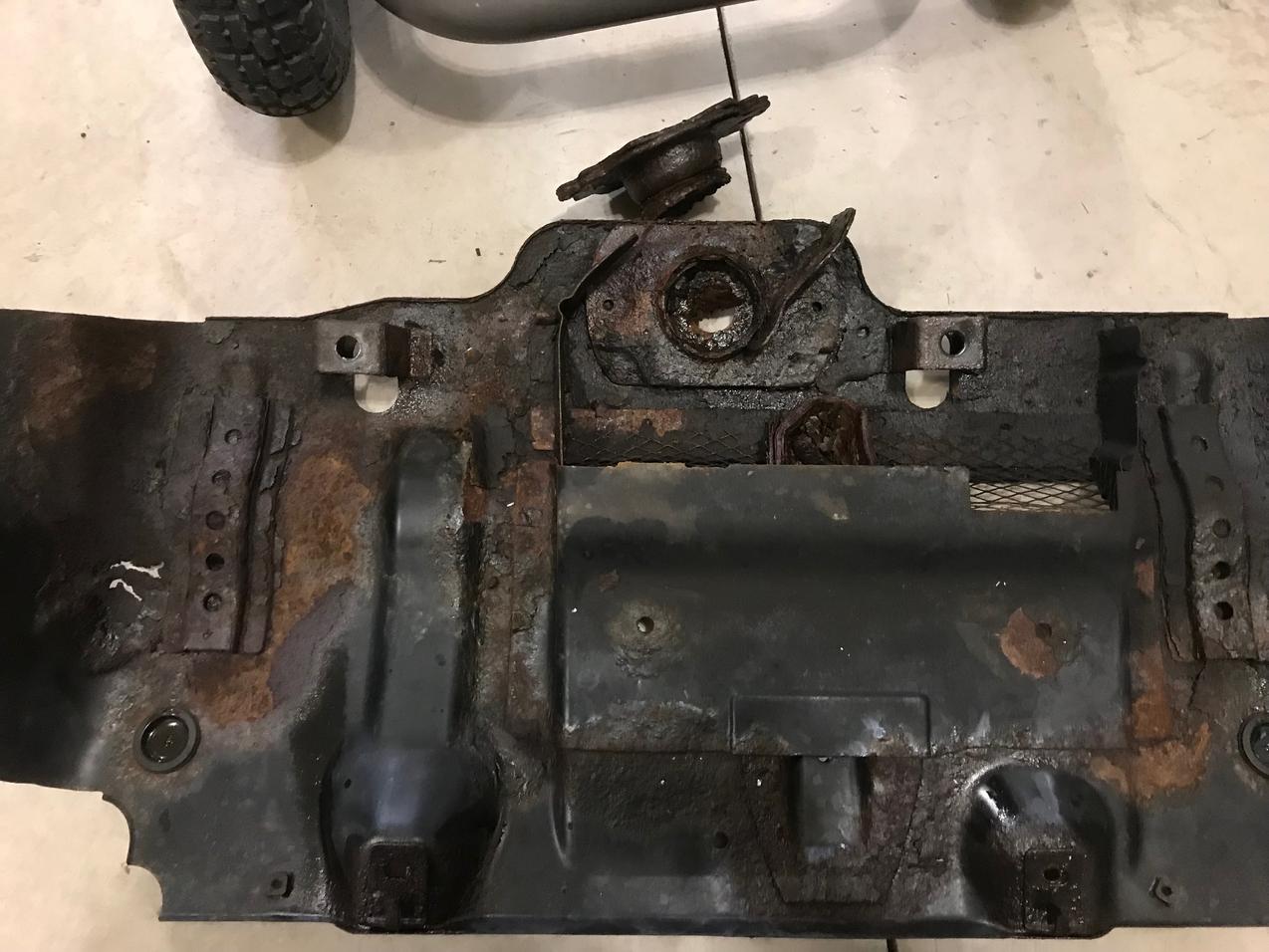

Can anyone tell me if the piece that came off with my skid plate is part of the skid plate or something else? Or what its purpose is?
Can I reinstall without it?
Thanks!
yes you can reintall without it. its just for jacking up the truck if you want both wheels off the ground.

hard to tell with that picture being too close but ya, it looks like a mount rusted off of the skid plate.
if i were you i wouldnt put it back on and just buy another skid plate from salvage yard. why risk it coming of and hitting road damaging your truck
replace the oem skid plate, buy a better aftermarket one, or just leave the skid plate off altogether if you dont off road
As mentioned above, it looks like it's part of the skid plate designed to push against the crossmember if it were used as a jacking point. I put it back on without this piece.

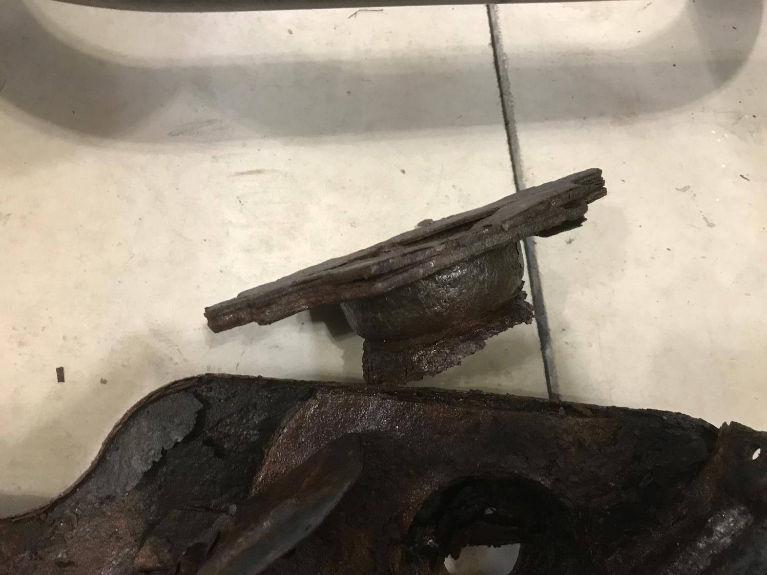

ok, that picture make things much easier to see
definitely not as bad as i thought and you should clean up that rust and repaint it so it last a few more years, otherwise it may rust through and need replacing after just one or two years.
skid plates arent cheap so its worth the effort put in to take it off, clean it up, and repaint it
