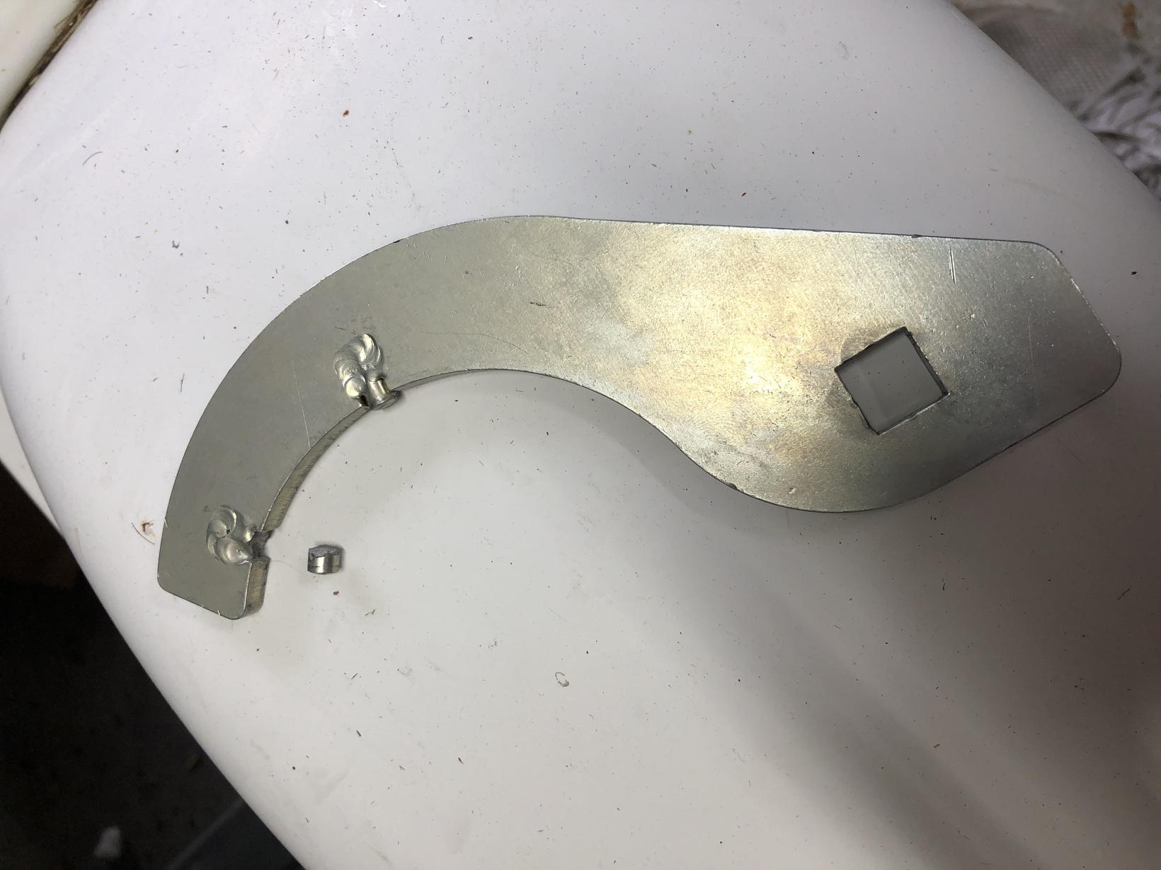

HELP! Spanner wrench broke during install!
Belaire23
I got my toytec Boss liftkit installed yesterday and I was making adjustments to the height of the passenger side coilover and the “tooth” on the upper part of the spanner wrench came off. Does anyone know any way to get these coilovers adjusted because now my sides are about an inch different and I don’t want to drive it back and forth from work like this. Any help would be greatly appreciated.

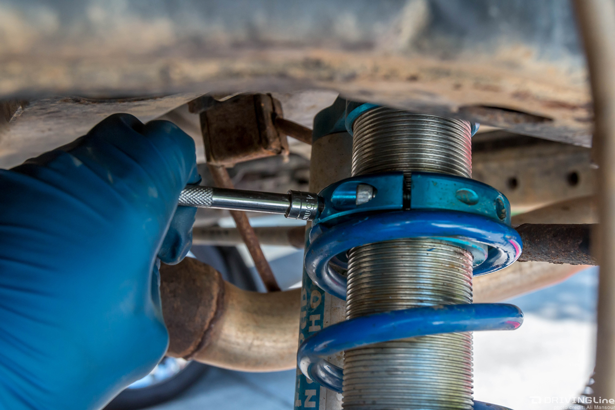

Most important thing you need to do is take the weight off the spring. So jack up your 4runner by the frame somewhere so the suspension is unloaded. I also like to spray some penetrating oil on them to help lubricate the threads. Not sure how much that matters - but it seems to help.
Edit: Also - depending on what shocks you have (there's a few different version of toytec shocks) there may be a set screw that you need to loosen. If you only have one threaded adjustment ring - it'll have a set screw somewhere. If there are two - they act like a jamb nut - so you need to loosen the one away from the spring first before you'll be able to move the other one.
I don't know all the details of toytec models - but the one thing to be extra careful is if it has a clamping style set screw like this don't open too far or it could come loose and the spring will release its energy potentially being veyr dangerous to you. Be careful if it's that style. Just loose enough to let it turn!
