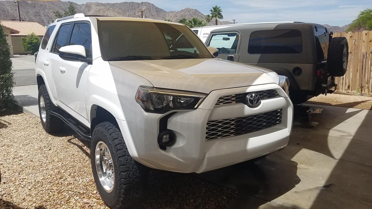

Is this a real question? HEH! 'Runner of course! It's a reliability kinda thing. Plus it's a true body on frame truck. I've had 1 SR5 and 4 Limiteds. Kinda partial to Limiteds for the amenities. Granted, I don't off road 'cept for every two weeks. I get to drive to the local quarry for shootin', that said, the off road guys will be of more help to ya in that area. Just had to add my 2 cents.
