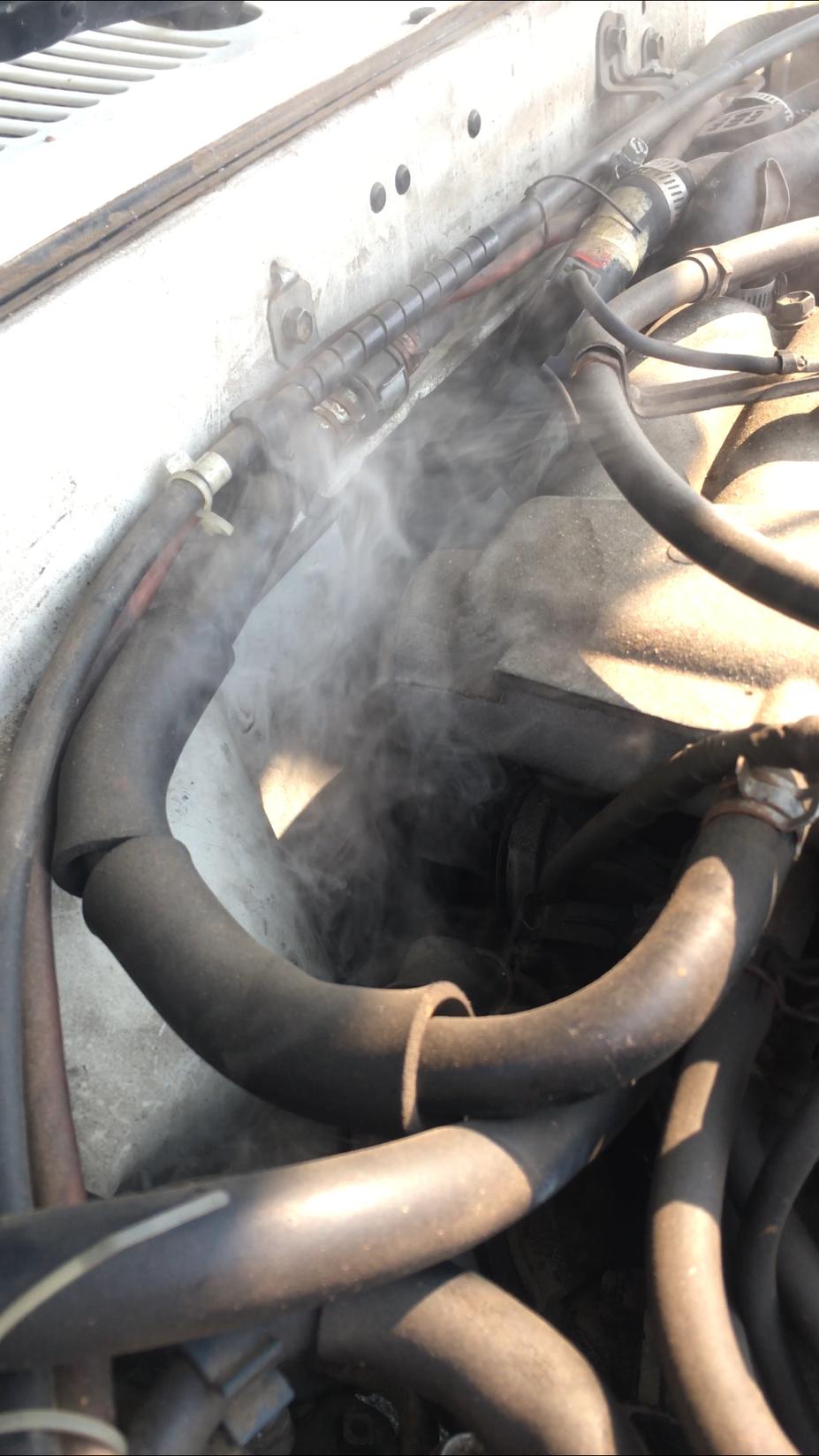

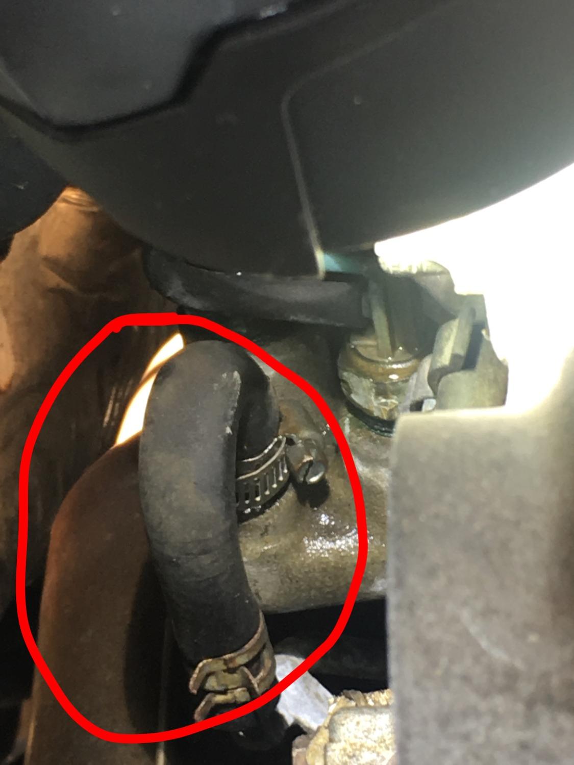

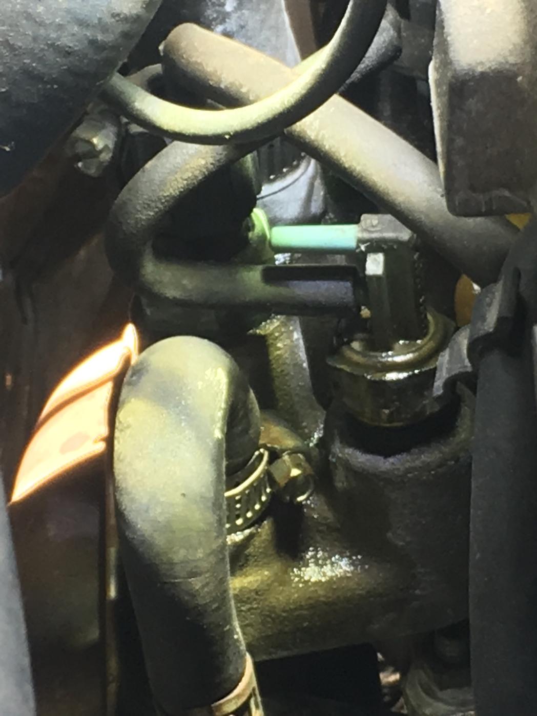

Hello everyone I’m not very familiar with car parts. I can change my oil and battery not much else to be honest I’m a stereo guy. But I’m having a leaky hose I think it’s driping coolant because my coolant is disappearing and the smoke is sweet melons it’s hitting my exhaust manifold and steaming up. A friend told me it may be the heater bypass hose ? I circled the hose that I think is the culperate to my leak. Another question is what is the area I’m getting wet right there that spark plug looking thing ? any help would be great Iv been apart of this site for a while tons of knowledge on here thanks everyone

I think it's called the water bypass hose. I had to swap mine too. I took to advanced auto and matched it to a similar U shaped hose and trimmed to fit. It's pretty easy to change with the intake off, but looks difficult with it on. Good luck!
I do believe it's called water bypass hose to.
Its easier to remove hose, and take it in to match it up.

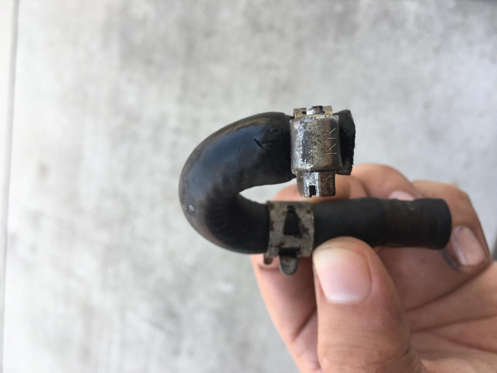

Right on thank you guys ! That’s exactly what it was called I was able to get a new one you can definitely see the crack in my old hose. I didn’t have to take off my intake, just rip the flesh off my wrist but it came :) thanks everyone
