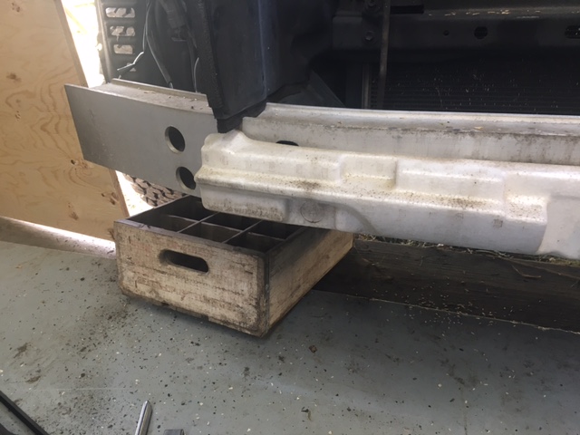

Behind the soft plastic front bumper is the best Chinese steel Toyota can buy.
Don't forget the foam and aluminum..............
