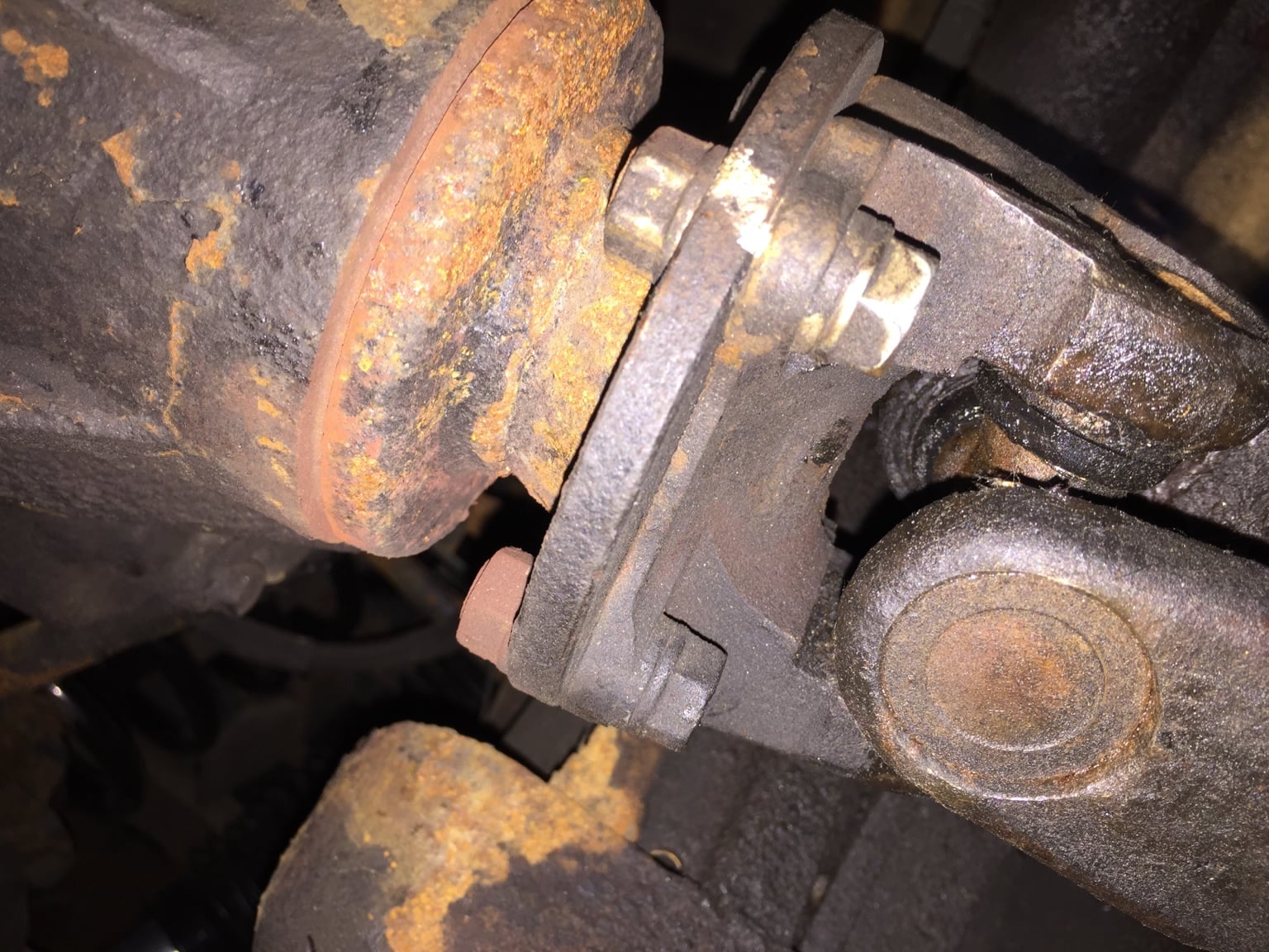

So I put the rear axle on jack stands and rotated the driveshaft, which revealed that the squeak is coming from where the driveshaft meets the rear differential. I tried to upload a video but it's failing, here's a pic, it's the rustiest part on the left.
It doesn't seem like this is a greasable part, but I jammed my grease syringe as close as I could and got some grease in there. This eliminated the squeak.
What part is this and is it serviceable?

After reviewing the schematics more it looks like the drive pinion is behind the part that was giving me the squeak.
I'm going to drain and fill the rear diff fluid, look for metal shavings. I kind of hope that doesn't fix the scraping/popping sound because it looks like best case scenario with diff work is $800+
The rustiest part there looks like it is part of the differential... so, maybe you have a bad pinion bearing or something?

That rusty part you're talking about is a little shield that's part of the pinion seal and spins along with the pinion flange. It may be contacting the diff housing while spinning, thus causing the scraping. If it's not bent from something hitting it and is only scraping the 3rd member housing intermittently, that might mean that your pinion bearing is on its way out and is letting the pinion move.
I would suggest unbolting the driveshaft from the diff, jacking the back end up and putting the axle on jack stands. Grab the pinion flange and try to move it around. If there is movement, you have a pinion bearing issue. If you infected grease behind that pinion shield it might be lubricating the shield when it contacts the 3rd member housing and just masking your problem.

I'm unsure if it was helped by greasing the pinion bearing from outside that cover, or from greasing the ujoints or slip yoke. I haven't gotten around to pulling the driveshaft and checking pinion bearing for play. For the time being I'm just going to be vigilant and keep listening and maybe periodically shoot some more grease into the pinion bearing dust shield area.

I ended up using a syringe attachment on a grease gun to shoot some heavy duty grease into the part where the drive shaft attaches to the 3rd member and where I think the pinion bearing would be.
That immediately fixed a very easily identifiable squeaking sound I was getting and it seemed to help with the scraping sound I was getting as well.
I've been driving it for the past year, and I don't notice the sound anymore, so it seems fine. I do re-grease it every few months when it sounds like the squeak might start again.
