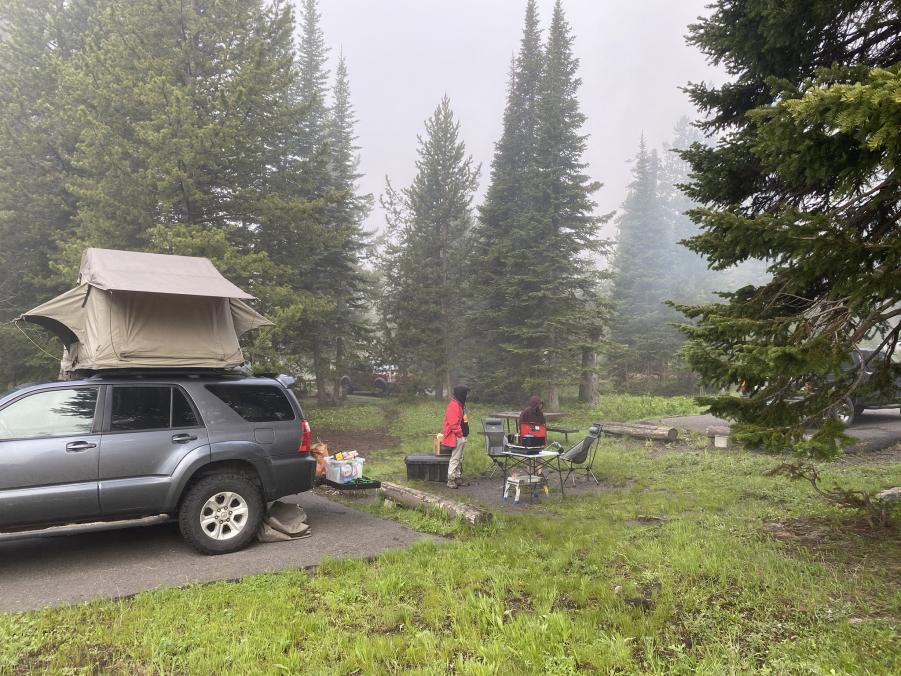

Coil rite
I put Firestone coil rite Bags on my t4r and couldn’t be happier. Less than $100. I packed my rig For a trip to Yellowstone. Was super heavy, carry rear drawers full, RTT and a hitch mounted shelf carrier loaded Up. Probably 400 lbs in the back. Bags were at 12psi and I had no issues at all for a trip that went 1300+ miles.
