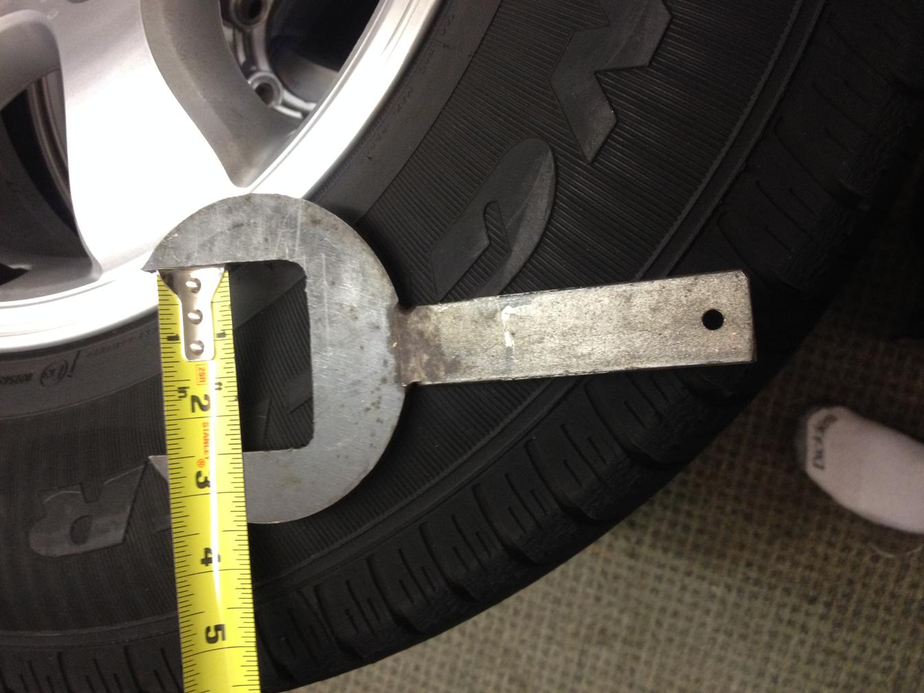

Make a tool like this to hold across the bolts. My dad made this and it works slick.
