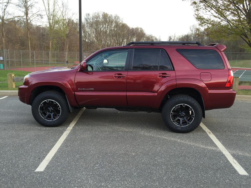

Thanks, I figured it out!

WHat setting are the front billes set to?

Man that looks awesome, I'm about to do the same thing (Just ordered the 5100s). What settings did you go with on the front shocks? I run a v6 as well and I like the lift you've gained.
Thanks. I'm very happy how it turned out. I have the fronts at 1.75 coupled with the fj coils. I also have a 1" spacer in the rear. Tires are 265 70 17. Be ready to replace your cv axles as an FYI.
About to start the same on mine. Why did you have to replace your CV axles? Just wear & tear and the lift ended up being too much for them, or?

the cv issue is common, there is a bunch of threads on it too. i think basically from the rubber on the boots being in the same position for 9+ years it doesnt like to be moved, and when we did the lift, they tore after a little driving.
Billstein 5100 shocks front and rear, if you go to autoanything.com it will walk you through the right stuff.
the fj springs
1" cornfed rear spacer
