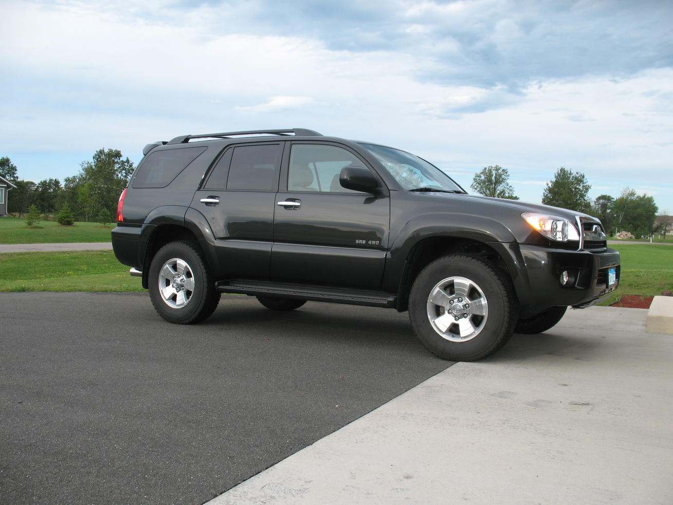

Here is my 07 V6 4wd with springs and shocks from a 08 trail teams with the toytec 1/4" spacers(1/2" net lift) and 265/70-17 tires. Great set up for a DD imo. If you have a V8 I would go with the 1/2" spacer to take care of the extra weight.
