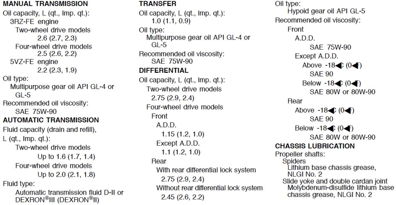

Honestly I think I read it on the forum about MT-90 in the transfer case, but I've been doing so much reading on fluids that maybe I miss read something. I do know that in the manual for the 5speed and transfer case is recommends API GL-4 or GL-5.
Based on the manual suggesting of the same type of fluid for both the transmission and transfer case, and everyone recommending MT-90,(and feeling sure I read that it would be ok, gotta look through my browser history). I feel comfortable using MT90 in my transfer case.
If anyone has advise against it I'm all ears.
This is from the manual. The recommendation for fluid is the same for 5speed and transfer case, which to me means it would be OK to use MT-90 in both.? (sorry for the huge pic)

It seems like it would work, since, as you stated already, the manual calls for GL-4 or 5 in the transfer case, and MT-90 is a GL-4 oil. I think the real question is, would it be the best choice for it? Everything I've read on here has recommended 75w-90 for the diffs and transfer case, which definitely isn't to say that MT-90 hasn't been recommended on here before, I just haven't seen it.

MT-90 is GL-4. People prefer it over GL-5 in the transmission because they are afraid sulfur additives in GL-5 can attack yellow metals used in synchronizers, despite Toyota's approval for its use. I share this fear. But otherwise, GL-5 is the superior lubricant especially for diffs. So using MT-90 in the TC is fine, but a GL-5 might be better and there is no reason not to.
I use MT-90 in the trans, but I use a cheap synthetic GL-5 everywhere else. I'd rather change it more frequently and use something more economical in those boxes. Redline ain't cheap and I don't think diffs are that picky.
