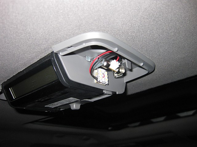

Here's what I have x3 - 2 for the middle and one for the back. Even though the two fronts are pointing to the side - you can't tell through the lens and they provide plenty of light. I do wish I would have gone more powerful on the rear/cargo however.
Finally, I ordered the two for the middle at two different times. The hue/color of the two look just a touch different. It was annoying to me at first, but now I just don't care. Wait, now that I mention it it does annoy me again ;-)
Everything I bought was from v-leds.
