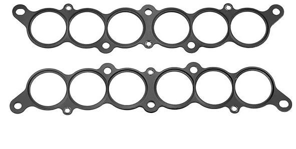

Thanks, I appreciate the advice. If the metal gaskets can be re-used, I would only need these, right?
Those are the metal plenum gaskets. Don't have to disconnect the throttle body from the top plenum. Disconnect the intake the vacuum hoses and the accelerator cables from the throttle body. Would be able to lift the top plenum off with the throttle body still attached to it.
