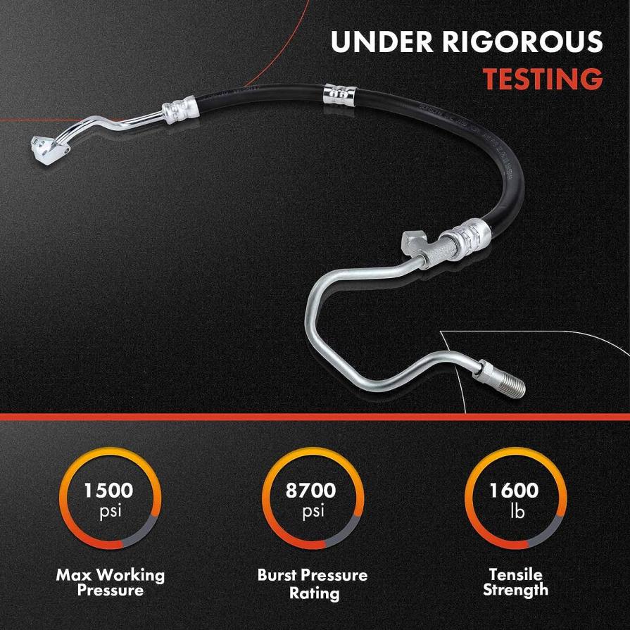

hose with threaded fitting
If its truly the return line its not under pressure. Reinstall the old part and cut off the leaking section. Hose clamp a hose to the stub and rout it back to the res. But if its the pressure hose from pump tighten it a little more or return it.
Your pic shows a pressure line. The return line from rack to reservoir will have a threaded fitting to the rack ( driver side ) and hose clamp at the reservoir ( passenger side). If leak is at rack side, you may have cross threaded when installing fitting to rack ( apparently quite easy to do ). Hope its not the case here. Like others had mentioned the return line sees very little pressure, just head ( height difference between rack/reservoir ) and some line friction forces from rack to reservoir.

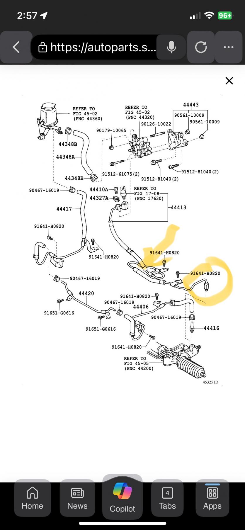

It’s the pressure hose then. The one with the threaded fitting on the drivers side. I can’t get it to thread at all now. I had it threaded, it leaked pretty bad so I thought I hadn’t done it right. Took it off the car to start all over again. Now I can’t get it to thread at all… so frustrating!! It’s at kind of a weird angle. I’m not sure what I’m doing wrong.
