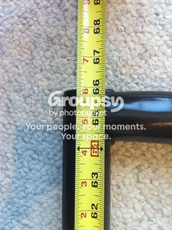

Length 66"

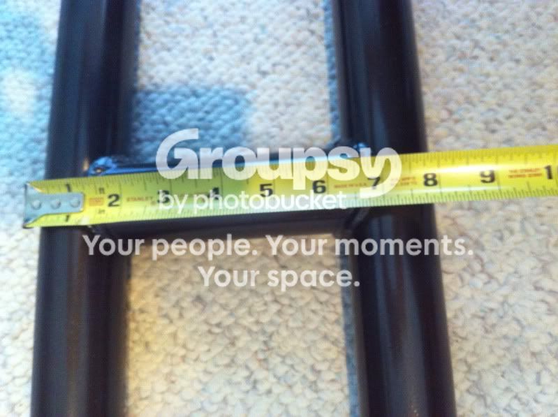

Width 8" at the skinnier section

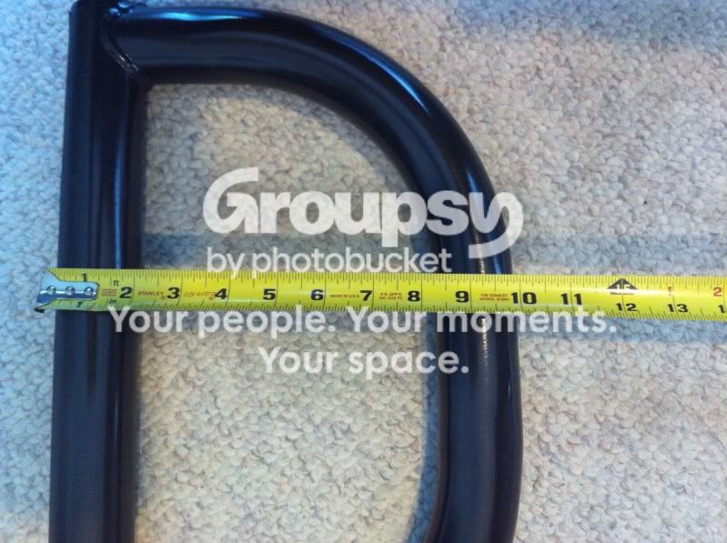

Width at the kickout, 10"

Hey, thanks for all the response guys. Those measurements are exactly what I was looking for. I kind of like the idea of diagonal crossbars too, begs some thought. If anybody else has sliders with dif measurements, maybe a wider or longer kickout section, that would nice to see. The guys are wanting to get a prototype to fit to my Runner by end of next week. This def helps a ton.
