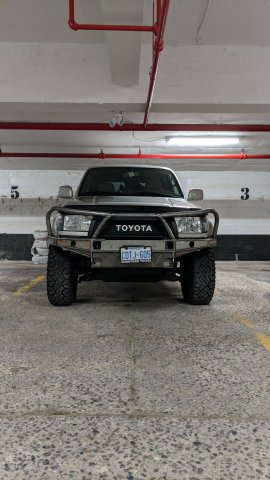

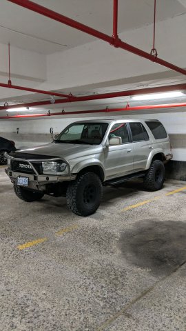

Front skid plate
So after getting my SRQ Fabrications skid plate installed which was a tight fit because if the 1inch diff drop, the popping sounds I was experiencing earlier have drastically reduced!
When I say the skid plate is tight, its basically up against the front diff.
Trying to understand what the skid plate has done to reduce the noise, anyone?
