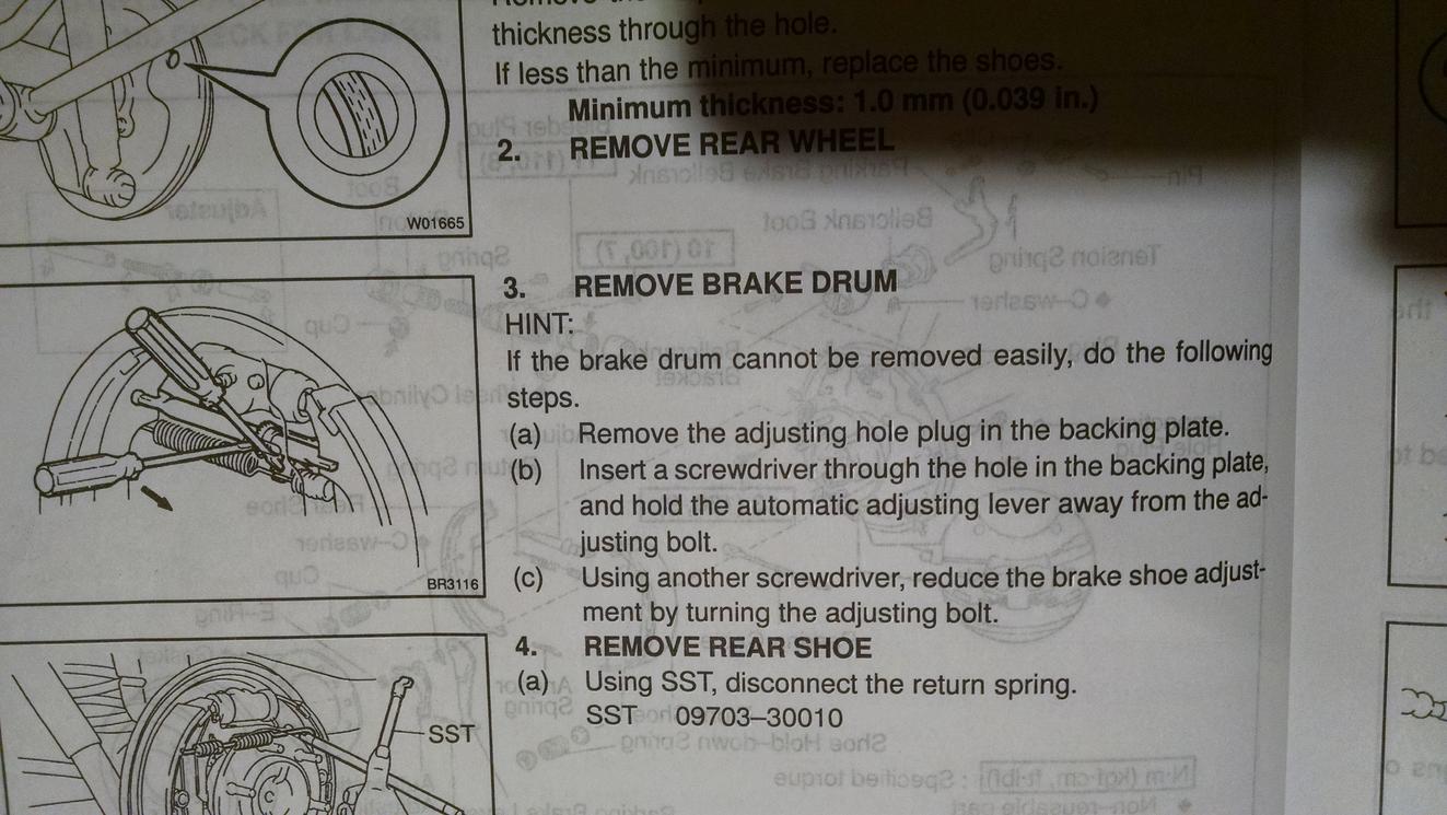

I was doing some research on brakes in my FSM and I came across this:
I reckon the FSM agrees with the method I used as well. I'm still fairly new to Toyota 4runner Forum Life but it really is a bummer when a dude starts a thread and then disappears not letting anyone reading how he finally found a solution to his problem so others researching a similar problem can benefit.
Maybe he'll read this and let us all know.
