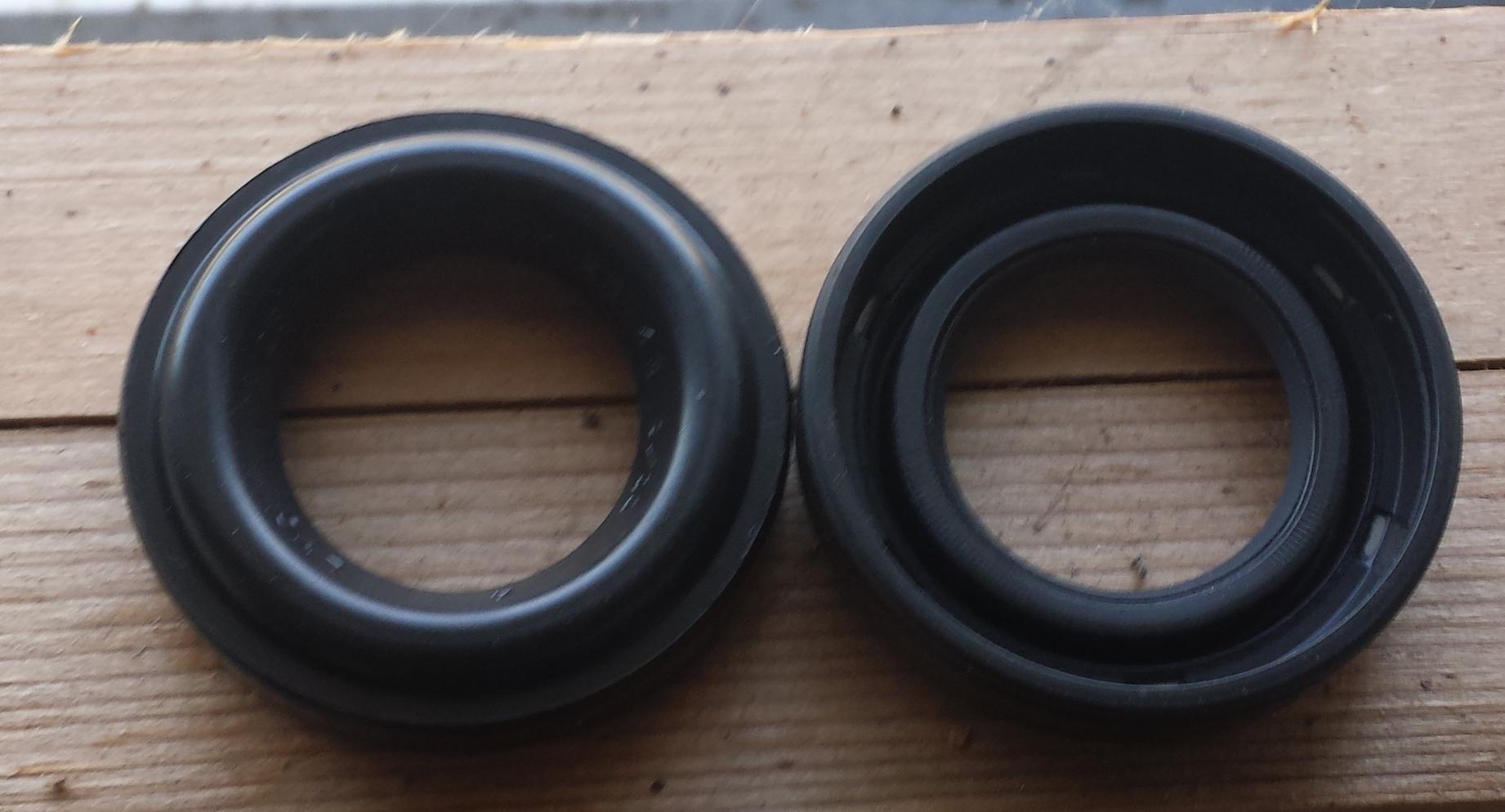

here is a pic of 2 new seals. the one on the left would allow the spark plug tube to start I think but would be up side down.
I hope you can see how the seal flares out.
the one on the right shows how it is installed but will not go over the tube

they have to be snug....you just put a little oil on em and run your finger inside them to slip over the tube....

Continue doing this. Start at the rear seal, running a small screwdriver around it while pressing it down. It will slip over the plug tube. Then do the middle one, then the front one. They can't be done all three at once, but one at a time and you'll have the valve cover on in a matter of seconds with just your won two hands. Don't let it defeat you.
I took a screwdriver and poked it down around the outside edge of the spark plug tube to get the seal to correctly sit on the inside of the spark plug seals.
I flipped them over lined it up and it goes on.

You did it wrong. There's been quite a few posts about the position of the seals. The open flared side goes down like this ^| |^.
The procedure above where someone described going from one end of the cover to the other with a small screwdriver or pick and running it around the tube until the seal drops around the tube is the way you do it.

You will definitely lose oil if you leave it that way. It'll fill the spark plug tunnels first, then start dripping down looking like your valve cover gaskets are bad. When I did mine, I somehow managed to get one side right and the other wrong. Thankfully the side I had to redo was the intake side so it was easy to get to.

I can tell you from experience, if the seal isn't put in the right way, it will eventually leak, and will get progressively worse
That's what I thought. The way the seals are designed and placed in, the flared part faces down so when pressure (crankcase pressure) goes against, it seals. Put in upside down, that pressure will squeeze out the seals, where they ride against the spark plug tube, and allow the pressure to escape. Would probably affect the PCV operation also.
