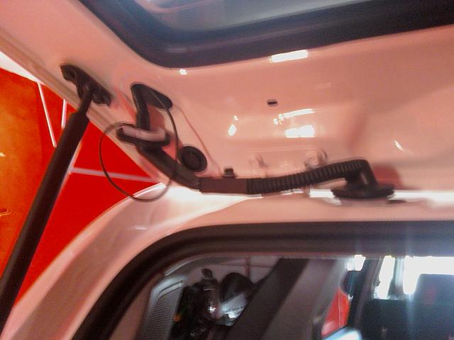

Hints: Make sure you wrap the wire to the camera around the existing wire loom. Inside the gate you will see a black wire loom, i zip tied my camera wire to this. Why? if you dont, its highly likely that the rear window will snap your wire on its way down.
Im attaching a picture of where i fished the wire through. Do not mess with the headliner to get the wire down into the cabin, you can run it through the piller that the back up mirror/pillar speaker is on all the way at the back.

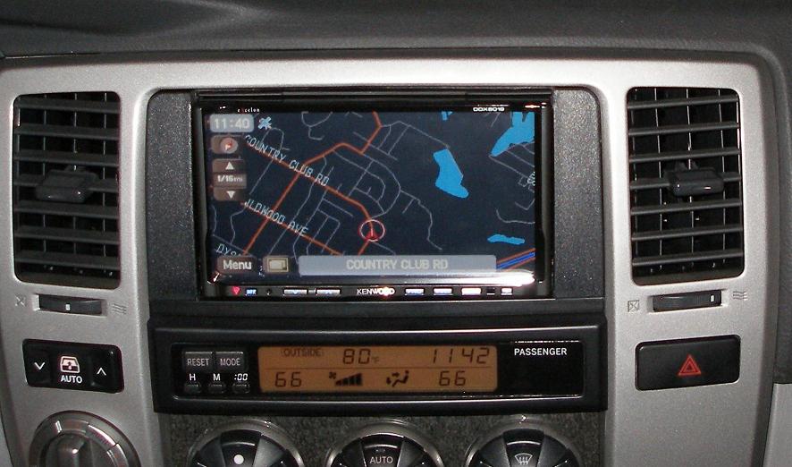

Hey Abe, how's it going? I was wondering if you have any pics of your modified 8210 installed?
I am running into the same thing with my Kenwood DDX8019 in my '03 Limited w/ JBL - the Metra 8210 trim doesn't fit around the 8019. So my next decision is whether I need to cut just the top piece out, just the bottom piece, or will I need to cut both the top AND bottom pieces out. I got ticked off with it, got my Dremel out and the battery was dead. Then I got ticked with the PAC SWI-JACK which I also installed (sucks it can only control specific predetermined items). So I walked away before I broke something, and I plan on reanalysing tomorrow when I get up. I might just say screw it and cut both top and bottom just so I can get it reinstalled and not worry about it any more. Any tips? Anything you'd do differently if you were to do it again?
Well, my dremel battery will be charged up by morning...
If you get a chance (ANYBODY), I'd really like to see a pic. Thanks!

Hey, no prob about the pic. The morning following my issues, I went back out in a much better mood and trimmed the bottom piece off, then trimmed the top up a bit and it seemed to fit perfectly. Definitely better than the version that just has the two pieces that mount to the side (8202?), in my opinion.
