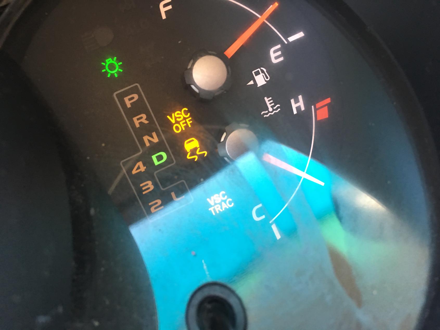

Last year lights came on (Check Engine, Trac on/ off) You know the ones that look like Christmas lights came on.....
Anyways, this year popped back on, took to shop they smoked it, replaced the gas cap, said maybe the filler tank neck. Few days later, lights back on. We replaced the Filler neck, reset it, and 2 days later comes back on. Need help trying to find out what to do w/ my next steps... Hoses? Read about canister HOLY HECK is that expensive. Any suggestions would be great! Thank you.
