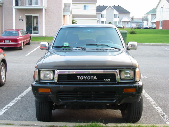

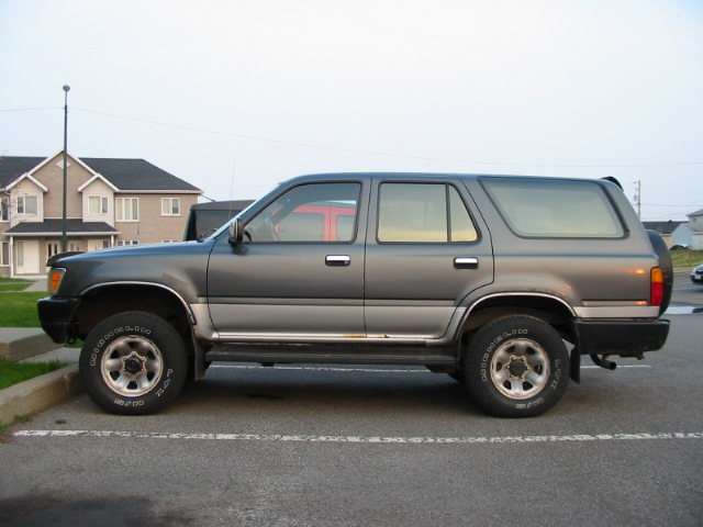

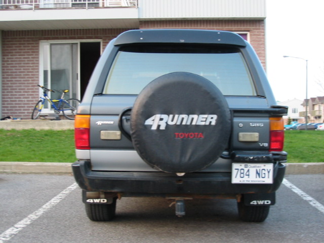

Hi all, I know you want to see it so here are some pictures.
Front

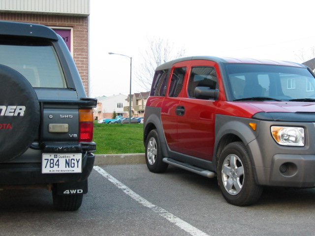

Next to something else
Here is the backside again, scaled next to some weird frame-less Honda thing.
