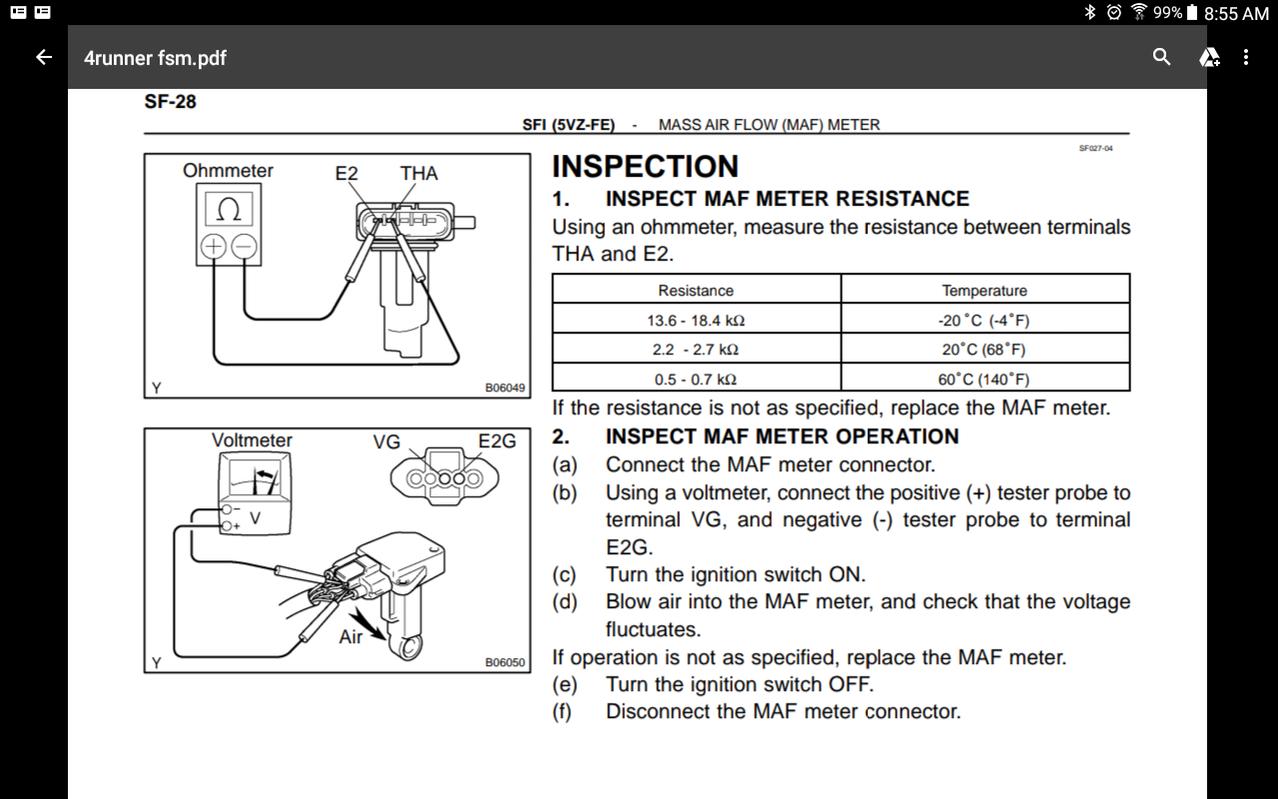

The maf can be working but still out of spec and and not throwing a code.
The engine response often means the air/fuel mixture is not being properly enriched or is going lean.
if you have a obd-II* scanner (you can buy one for around $30 and download torque app)check the data at idle of Long term fuel trim (banks 1 and 2),Sort Term fuel trim
MAF sensor input
AIT sensor input (Also need actual outside air temperature when you take this reading. will give you a better picture.
ohm test maf sensor

Just an update for everyone who helped!
I decided to just order a new MAF. Got a denso part 197-6020 for $70 off Amazon.
Works perfectly. Throttle response is great! No more hesitation!
Thanks guys.
