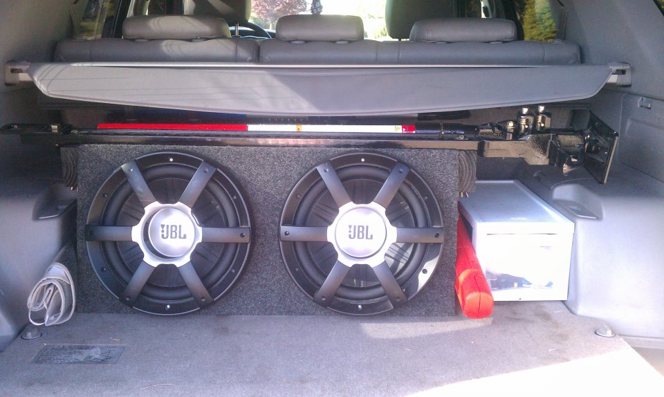

Here is mine.. Custom mounts on the box. Through bolted

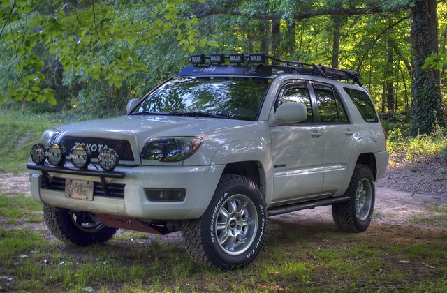

I agree - this is 3/4 of the way up on mine. With the sway bar disconnected the rear tire was still raised (and the 2" lift coils just fell out). With the sway connected I'd image the tire would be way off the ground.
Talk about flex!

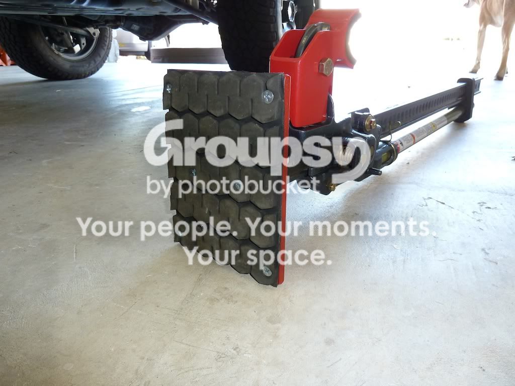

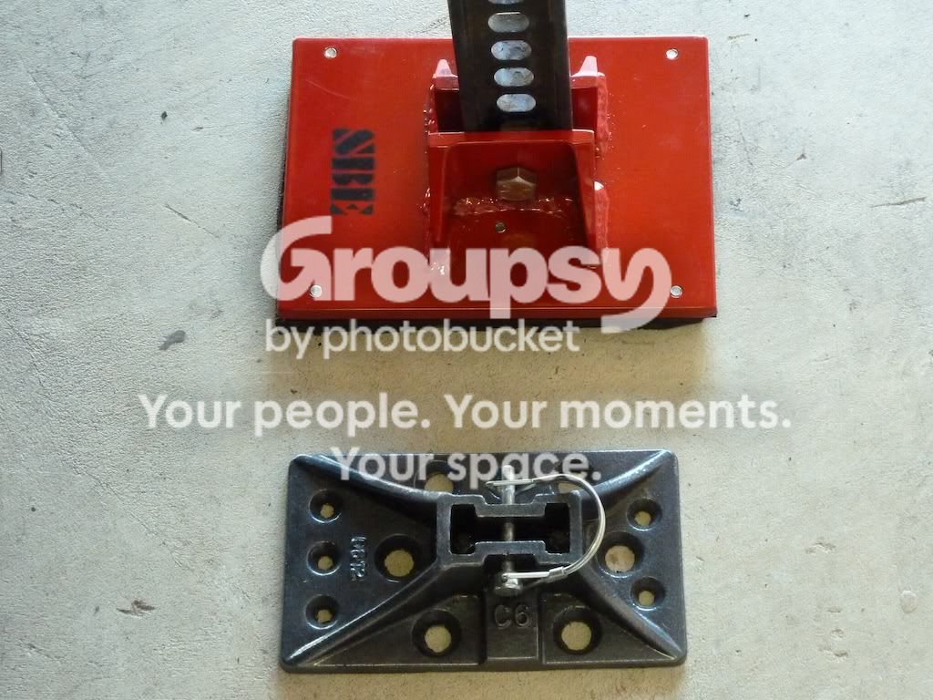

I have mine mounted on the rear bumper. Before I got the CBI, it was mounted on the roof rack. In addition to getting a tube adapter for your sliders and wheel strap adapter, I would also recommend getting a base plate from SBE Fabrication. It has a wider foot print and the bottom is lined with tire tread. The smooth metal base that the Hi-Lift comes with can slip, especially on smooth or wet surfaces.

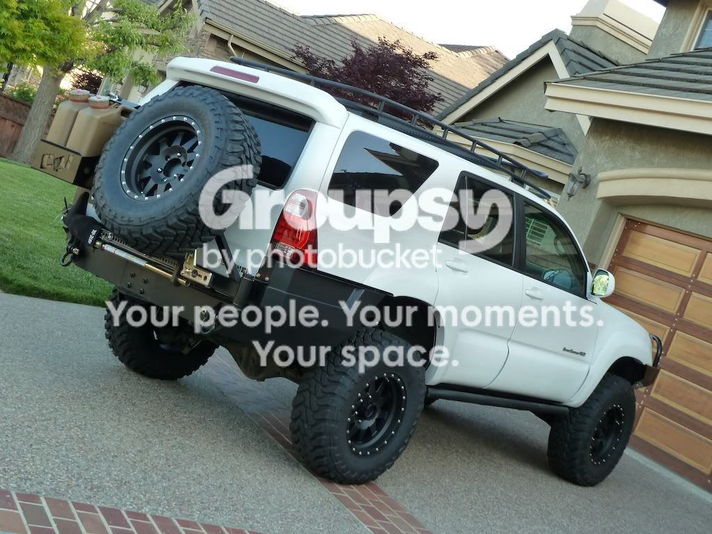

Mounted on rear bumper

SBE base plate

It appears they are sold out of the bases; not clear if plans to produce more but I think I could add that to mine. It is a great addition to increase stability.
