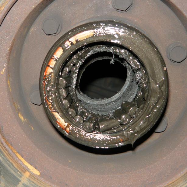

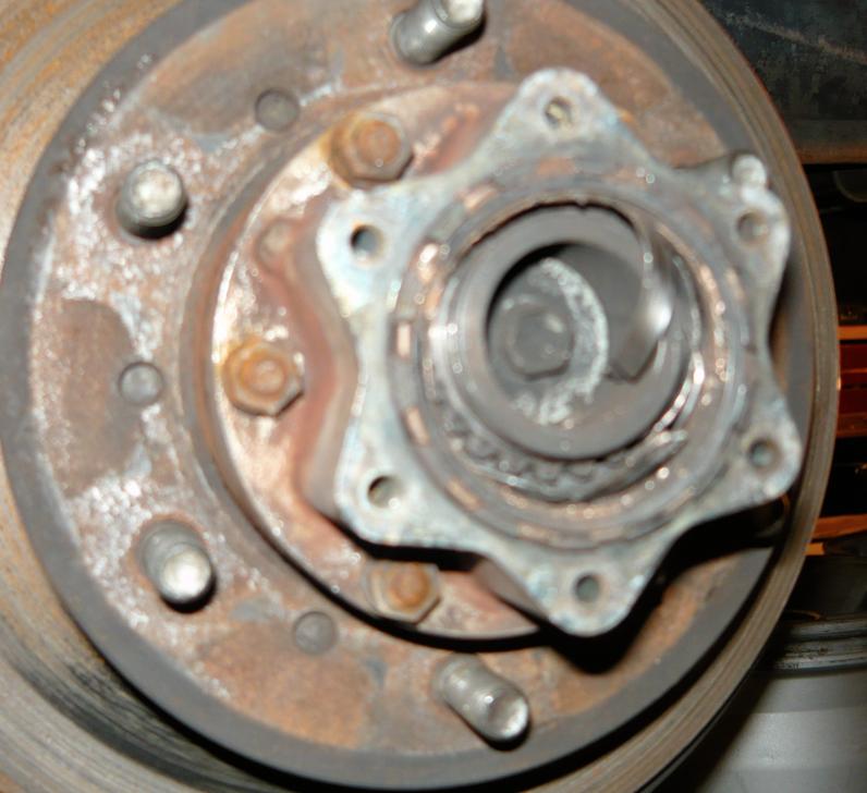

Hard to say. There are a couple of things that could be wrong. My first inclination would be the wheel bearings. Can you lift the right front tire and shake the wheel up and down and rotate it to see if you can hear the noise. If it is the bearings I would not suggest driving home on it.

Yeah I'm a little throw off by the grinding and the pulling at the same time. That's why I wasn't really thinking CVs. I know when my bearing went it went all the way. Of course it didn't help that the PO kept driving on it.

Here is a pic of what mine looked like when I got it home off the trailer.
