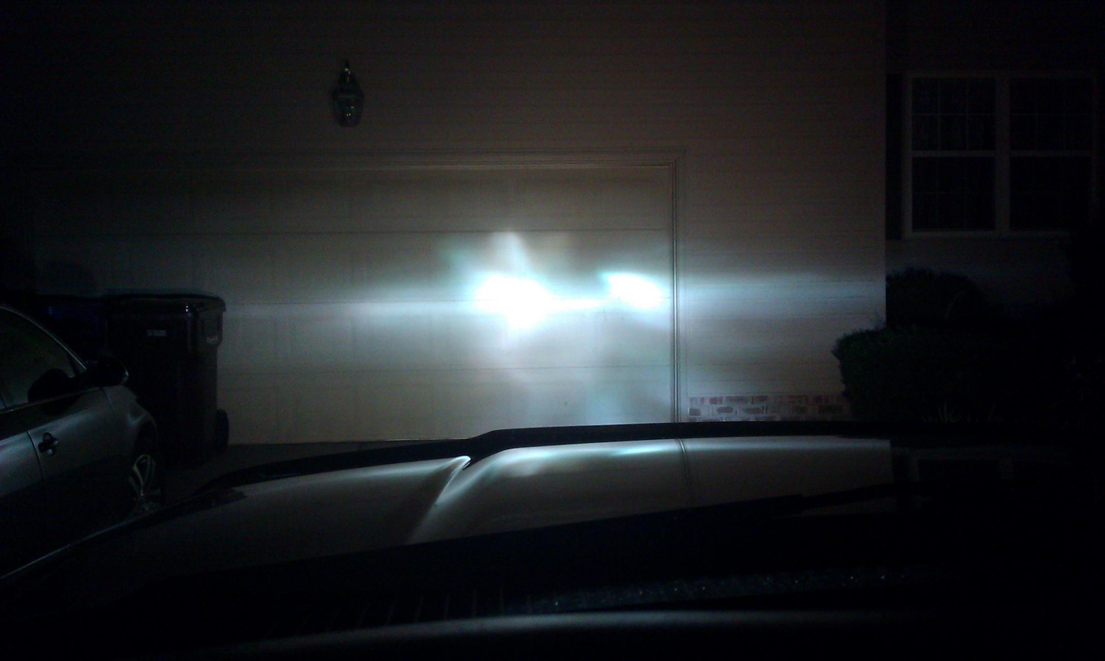

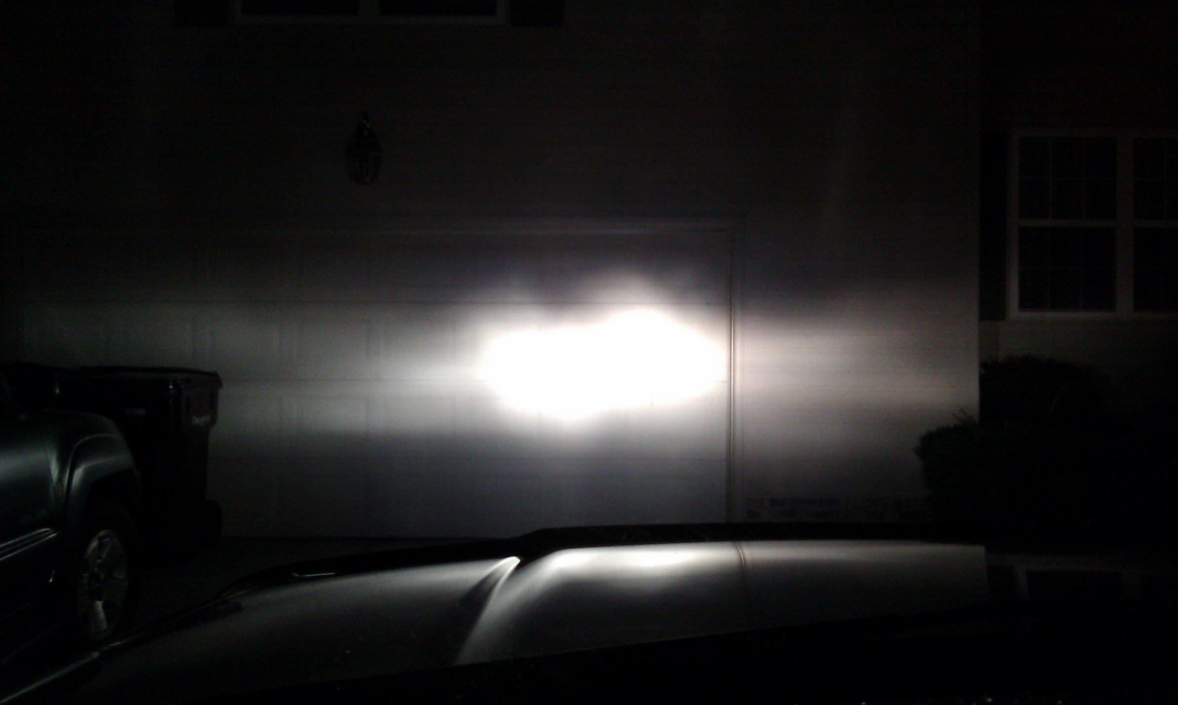

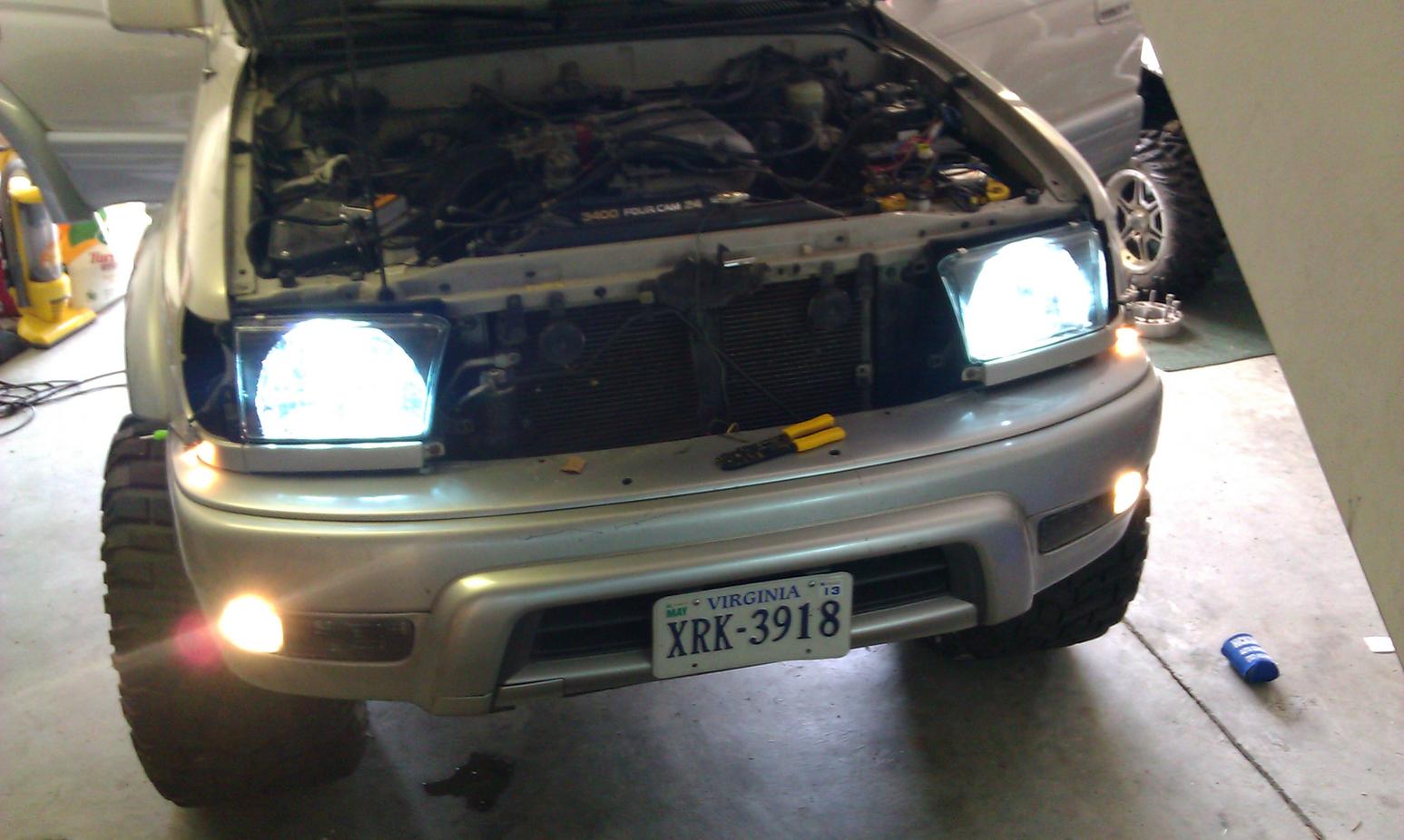

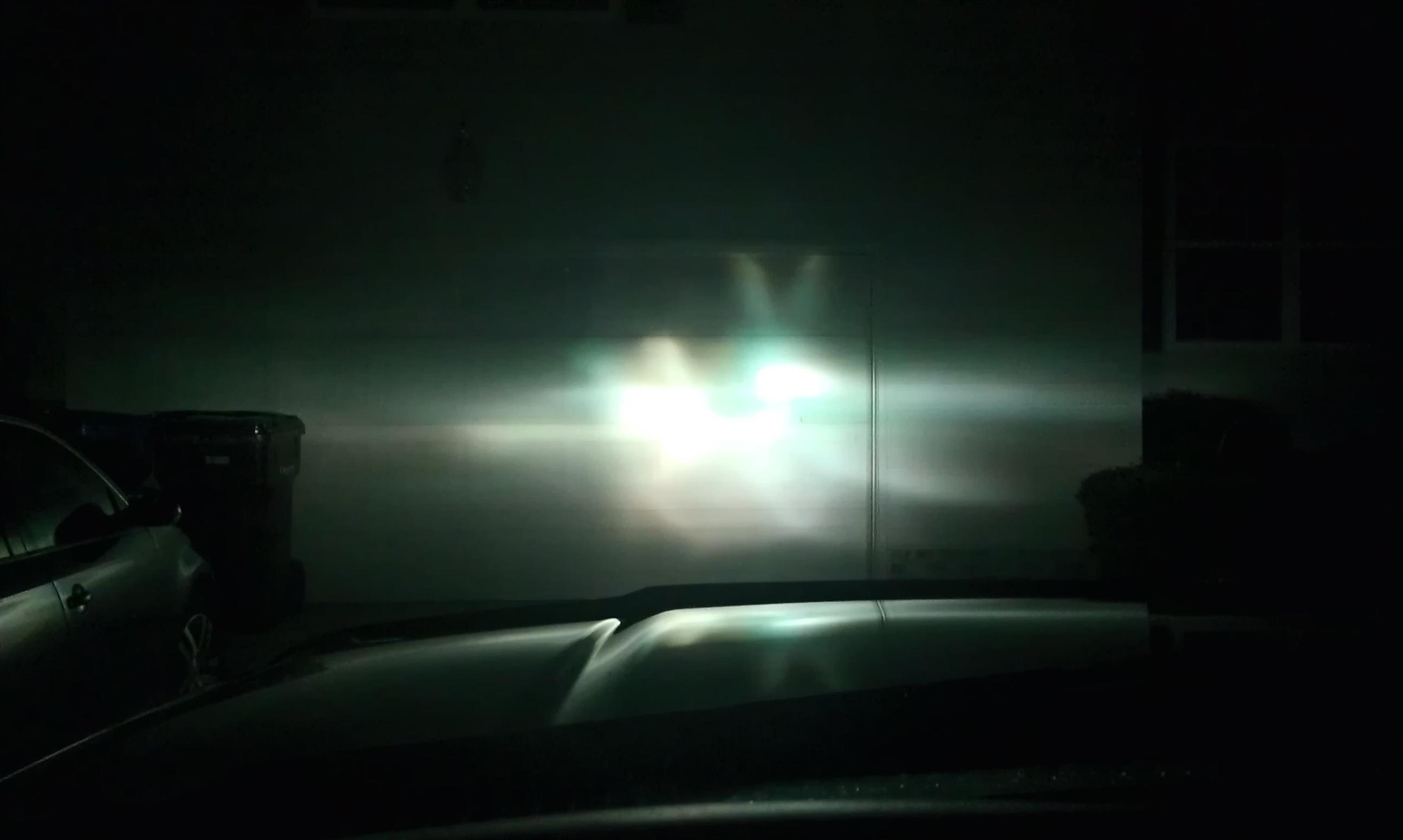

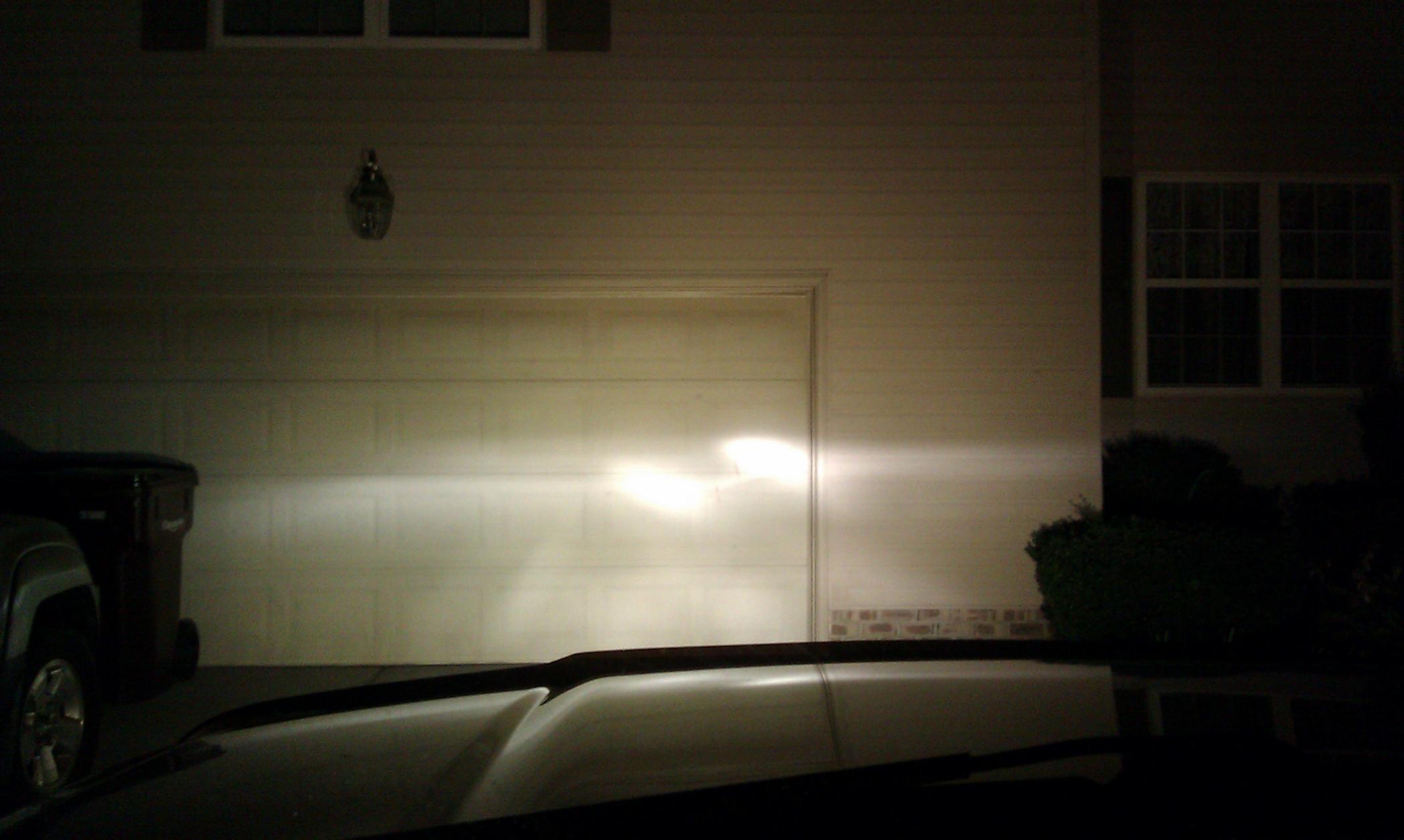

Finished my HID conversion kit today, here is some before and after pics, lemme know what you guys think
before
before with my brights on
after
and after with my brights on
and heres just another pic
what do you guys think?

i got to go get them adjusted again and im in chesapeake va, and they are the 6000k diamond white kit

Congratulations on pissing off and blinding everyone that you pull up behind or pass on the road. That light dispersion is terrible.
Edit: just noticed this thread was from 3 years ago, but my point is still valid.
You really should look into either getting some proper HID projectors or going back to halogen... I flash anyone who has glaring, bright, obnoxious PNP HID kits... There still is hope though take a look at the retrofit sources website and start doing some research also make tacoma world account because there is an ongoing group buy on there for 25% off anything on the retrofit sources web site. there are a lot of resources available here to help you not be that guy on the road so take advantage of them
