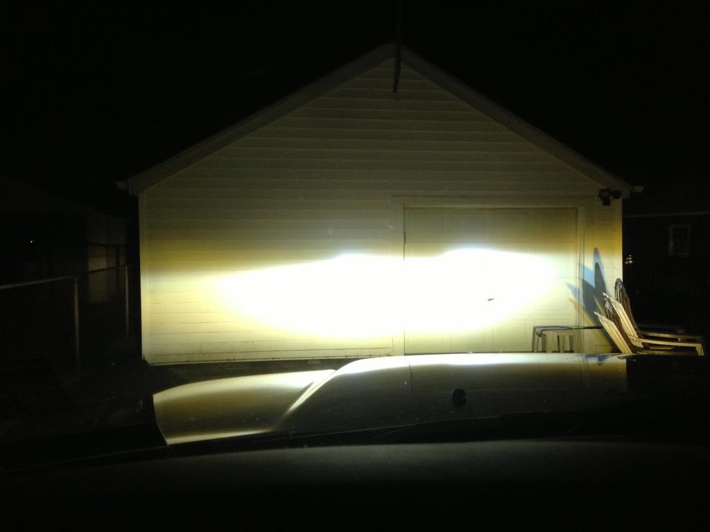

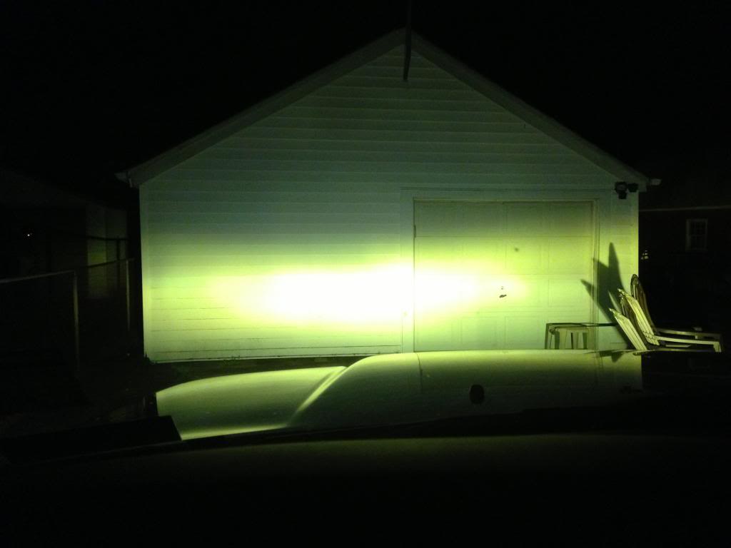

I've got an 06 and I put HIDs in the headlights and fogs. Like you, I went with yellow in the fogs because I liked the look and because they are better in fog and rain. Here's a picture of the fogs by themselves and a picture of the fogs and headlights together

Do you notice a lot of glare? The more I read, the more I am turning away from HID fogs. I use my fogs but it is still just a fraction of the time compared to low-beams. Might not be worth the price. Have also read that HID light is not the best for fogs, even in the 3K kelvin range. Maybe a pair of good yellow bulbs, I have heard good things about Hoen Endurance bulbs. I would still like to hear opinions on HID fogs in 06+ 4runners though.
I love mine, I have them on all the time, even when I don't have the headlights on. I notice zero glare. They really help out when driving in the rain. They make seeing the lines much easier for me
