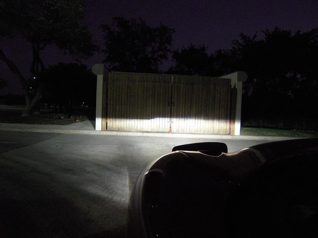

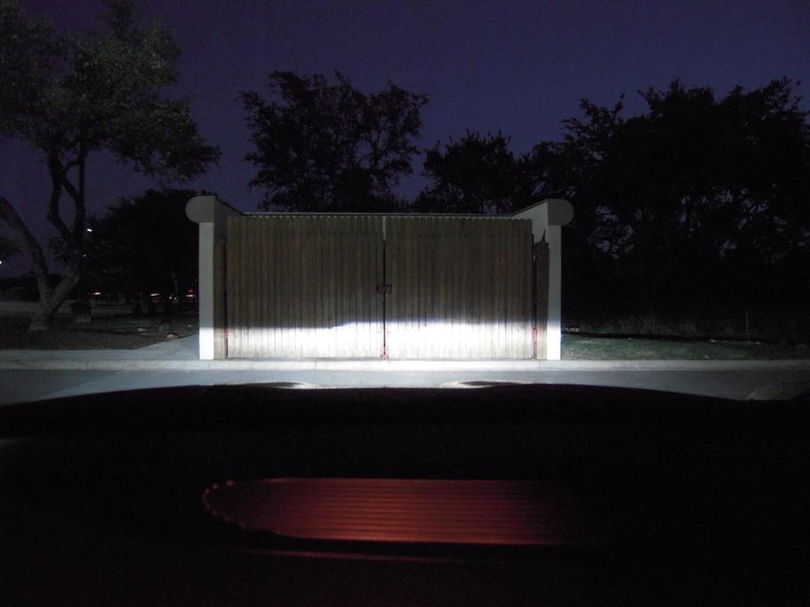

Here is a couple photos of my Firehawk with TSX projectors and 55w ballasts D2S bulbs. btw, retrofitting a car with pop-up headlights was a complete pain in the &^%.

I edited my first post with pics of my HID retrofit on the first page if your interested in seeing a TSX projector.
