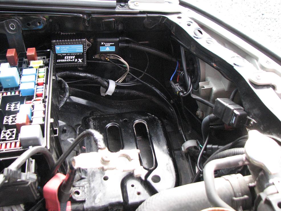

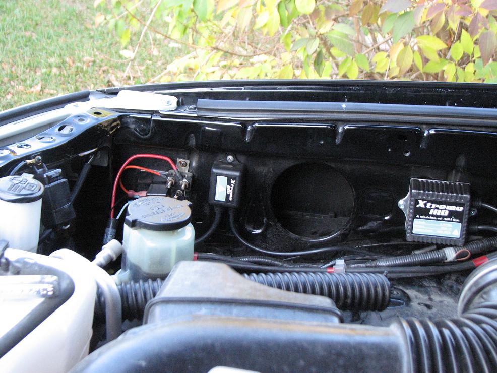

Trying to include pictures of my install. If it works..... Both relays mounted to front support near headlights. Left side: removed battery & mounted ballast to fender wall with included double sided tape AND screws. Right side: removed air cleaner box and mounted ballast to fender in same fashion. Disregard circuit breaker & relay partially hidden by power steering res.; that's for another circuit.
This is a Xenon Depot kit (with Philips bulbs) and I recommend it. I've only had it a couple weeks but it seems to have QUALITY components.

If you want to place them on the fender walls you will need screws, I tried the best double sided tape I could find, however with weather, cold & hot the tape will eventually give. The ballast just weighs too much, plus if you go offroad the last thing you want is that big metal item banging around. Get some stainless steel screws and drill a small pilot hole and then cover the screw with some clear caulking to avoid causing rust & use double sided tape. Only then will it be really secured.
