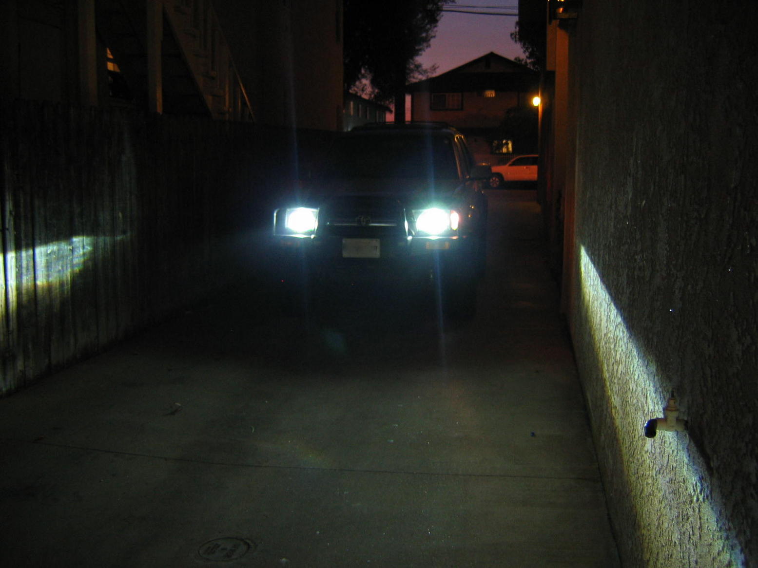

That's my retro job and I'm going to see if I could do a DIY with the amount of pics I took. Well worth the $80 to $90 it cost me. HANDS DOWN BEST MONEY YOU'LL SPEND.

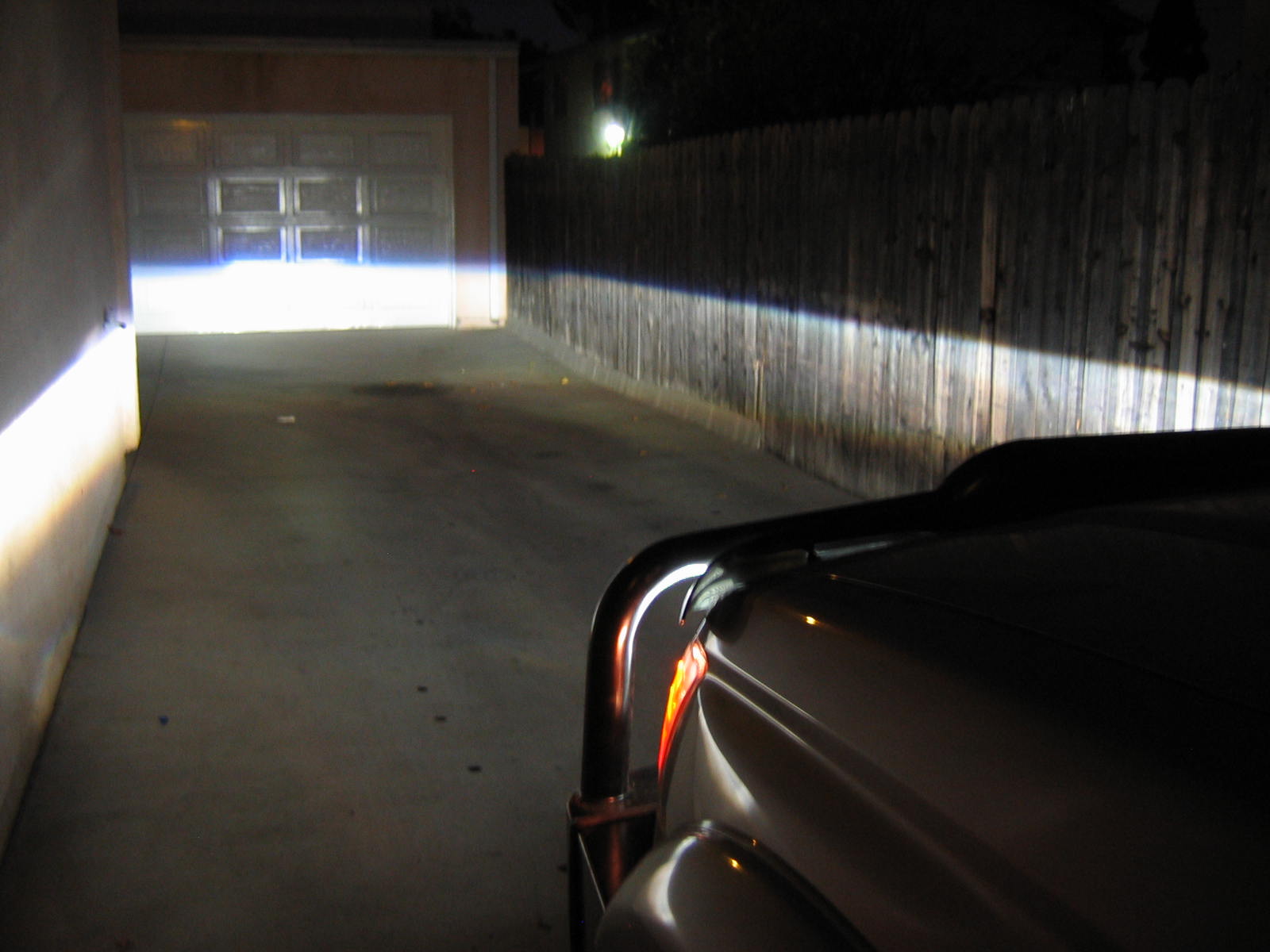

Cutoff from inside on the garage door

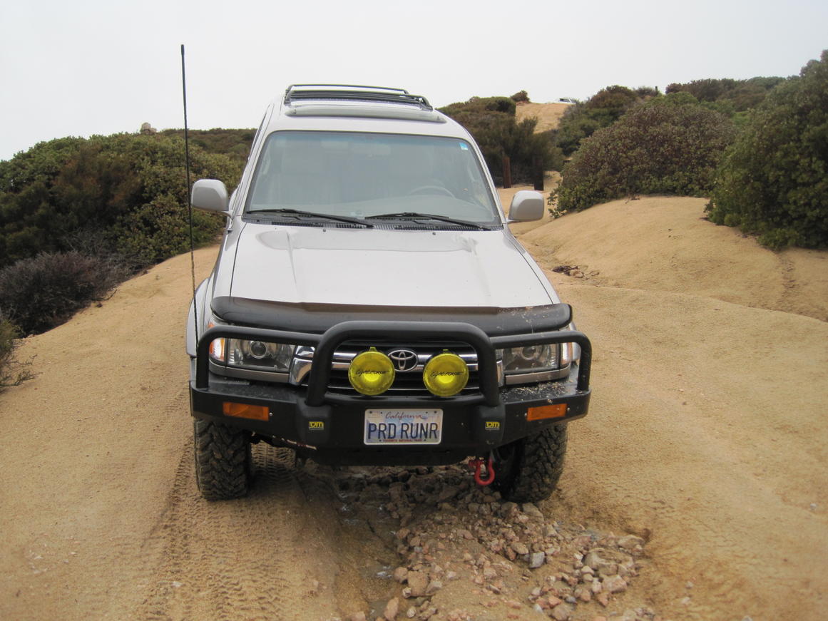

Hey Miller this is my retrofit. I bought the fx-r projector lense from The retrofit source. Very easy retro to do, hardest thing to do is aligning the beam cut off.

Your aiming is not correct. You need to line up the top of the cutoffs, not the top of the driver side with the bottom step of the passenger side. You also need to make sure they are aligned correctly at 25+ feet. Here is a aiming guide I did for G35 coupes, but the same principles apply. Measure the height from ground to the center of the projector lens, then then make sure the cutoffs drop 2-3" @ 25ft.
