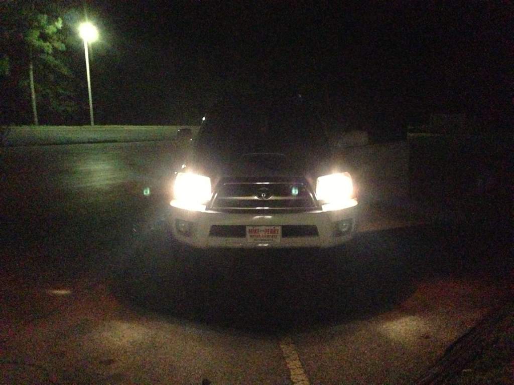

Oh I gotcha. I got them in sorta... One of the 9006 lights is still stuck in the canyon. I've tried everything. Ended up getting a little jolt, so I gave up tonight that's why only one fog light is hid.
halogen lows (gotta order some
lows and fogs (drivers side is HID, passenger is still halogen)
hi/lows
for a distance test this is at the driving range by my house. The trees are about 300-400 yards.
