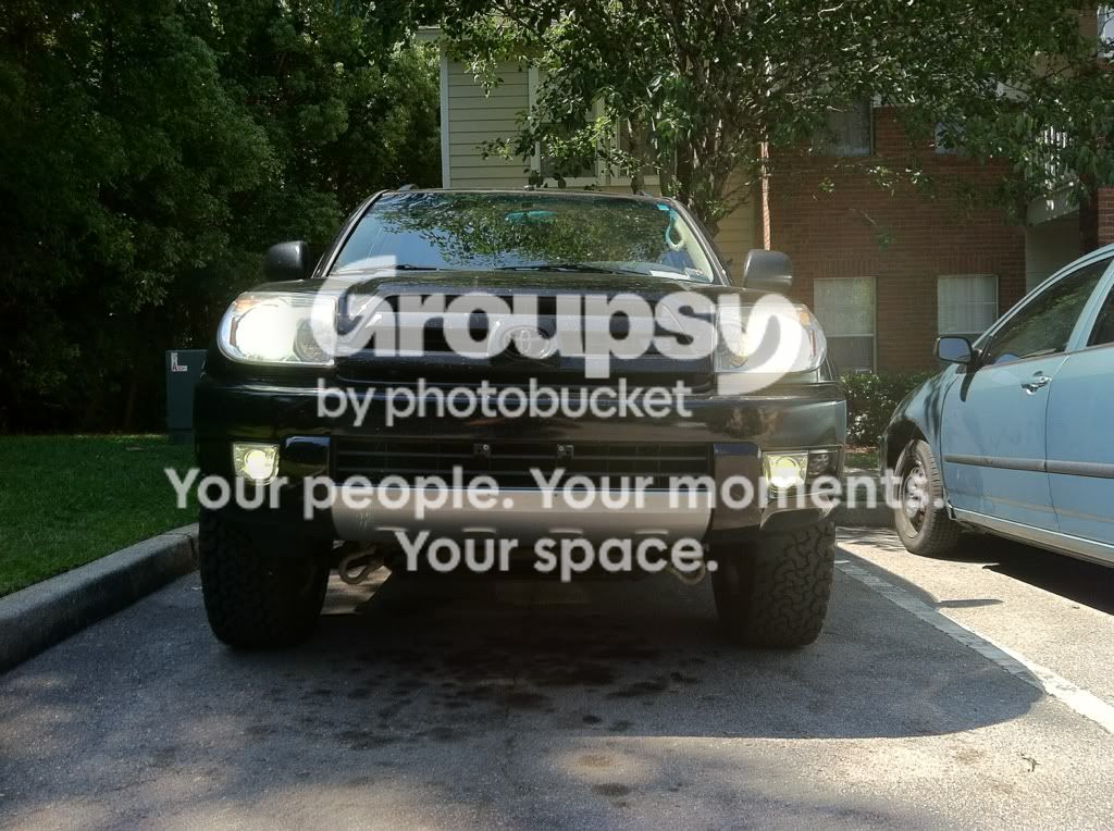

I am running 9006 clear view bulbs in both my low and fog lights with no problems now.
3a3b824e.jpg~original
Even drove through water deep enough for a bow wave to roll up onto the edge of the hood and didn't have a problem with the ballast.
Even drove through water deep enough for a bow wave to roll up onto the edge of the good and didn't have a problem with the ballast.
Are those 3k fog light HIDs? If so, that's exactly what I was planning on.
Yes sir they are, sorta wish I had gone a little more yellow. I am not sure if it's because they're cheap HID's or the color temp but they're bright yellow instead of deep yellow if that makes sense.
