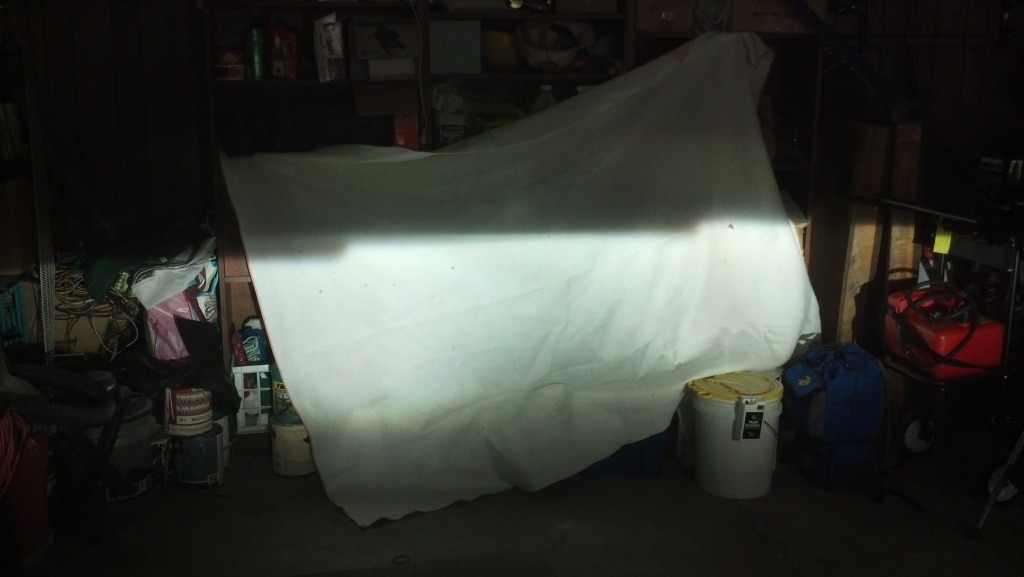

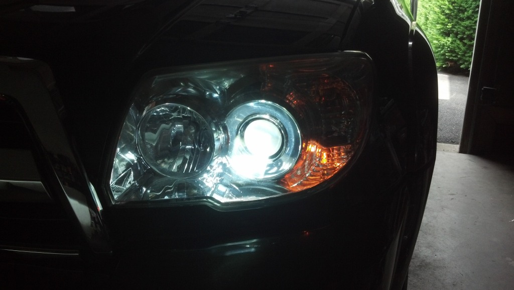

Here's my sweet step down cutoff and a shot of my 5000k's
