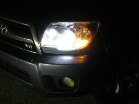

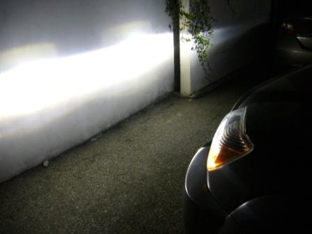

I'm not sure what the Prius HID's are but I installed 4300K in my 4runner and I've been really happy with my choice. They're really bright and white. The higher #'s...6000K, 8000K...are supposed to be more blue/purple. I attached some photos, not the best but hope they help.
