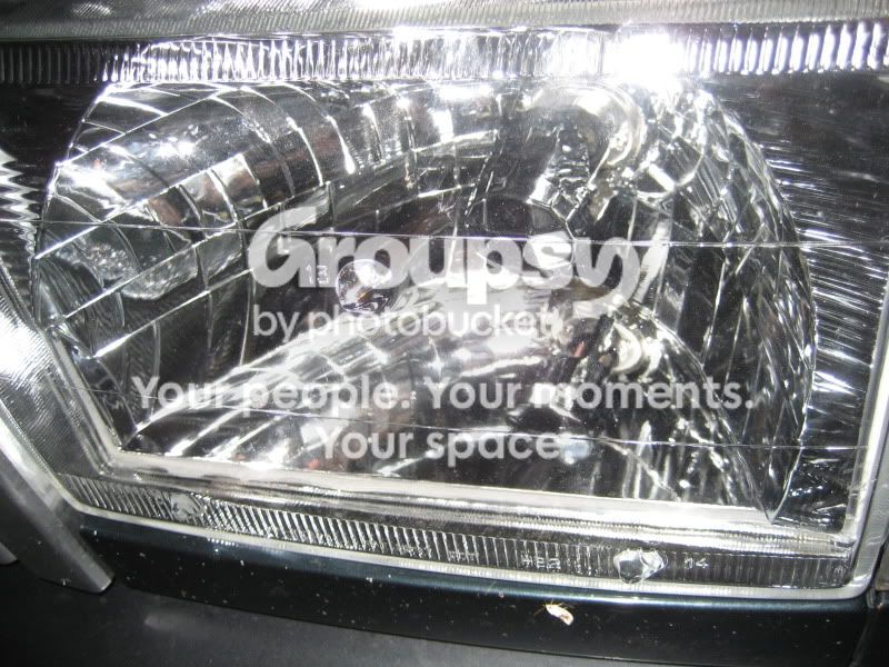

Moving forward, I recently just installed aftermarket headlight(99-02) assemblies on my 1997. After that I installed some 10K H4 Bi-Xenon HID's.
Install went well. The only thing I have some questions about is the headlight housings and beam patterns.

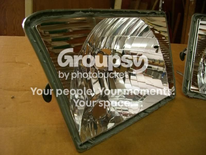

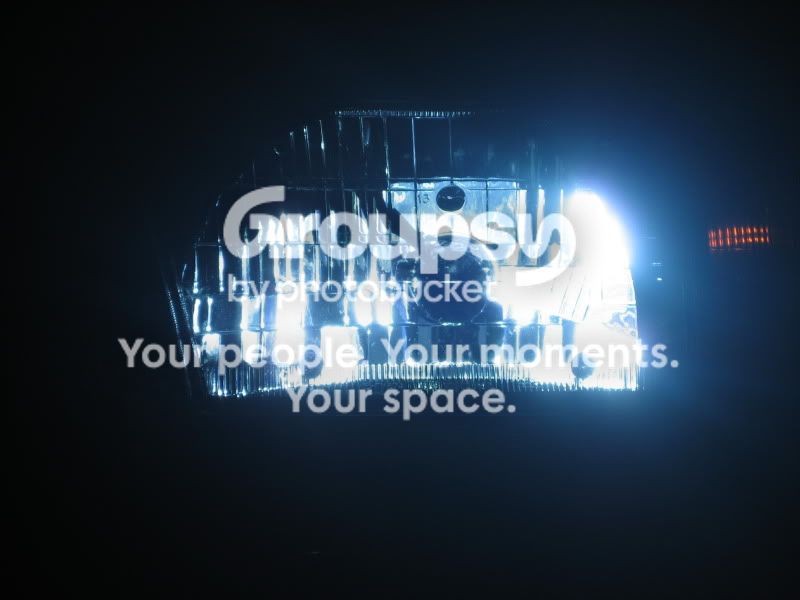

I have assemblies that look like this..
Picture017-1.jpg~original

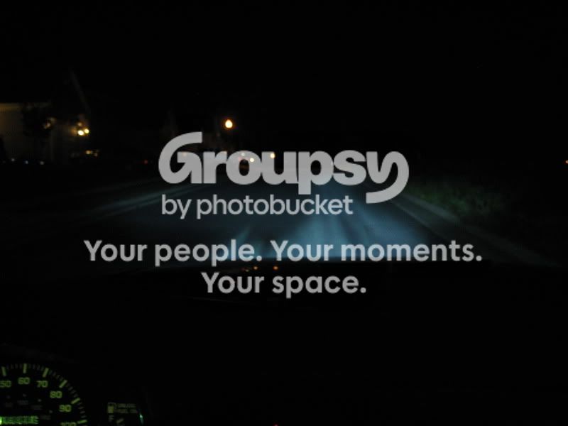

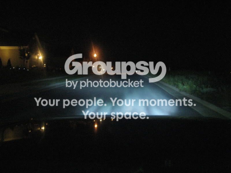

But with the HID's installed I'm seeing the lower end of the headlight assembly looking like this.. Notice the lack of light output at the bottom.
Picture006-1.jpg~original

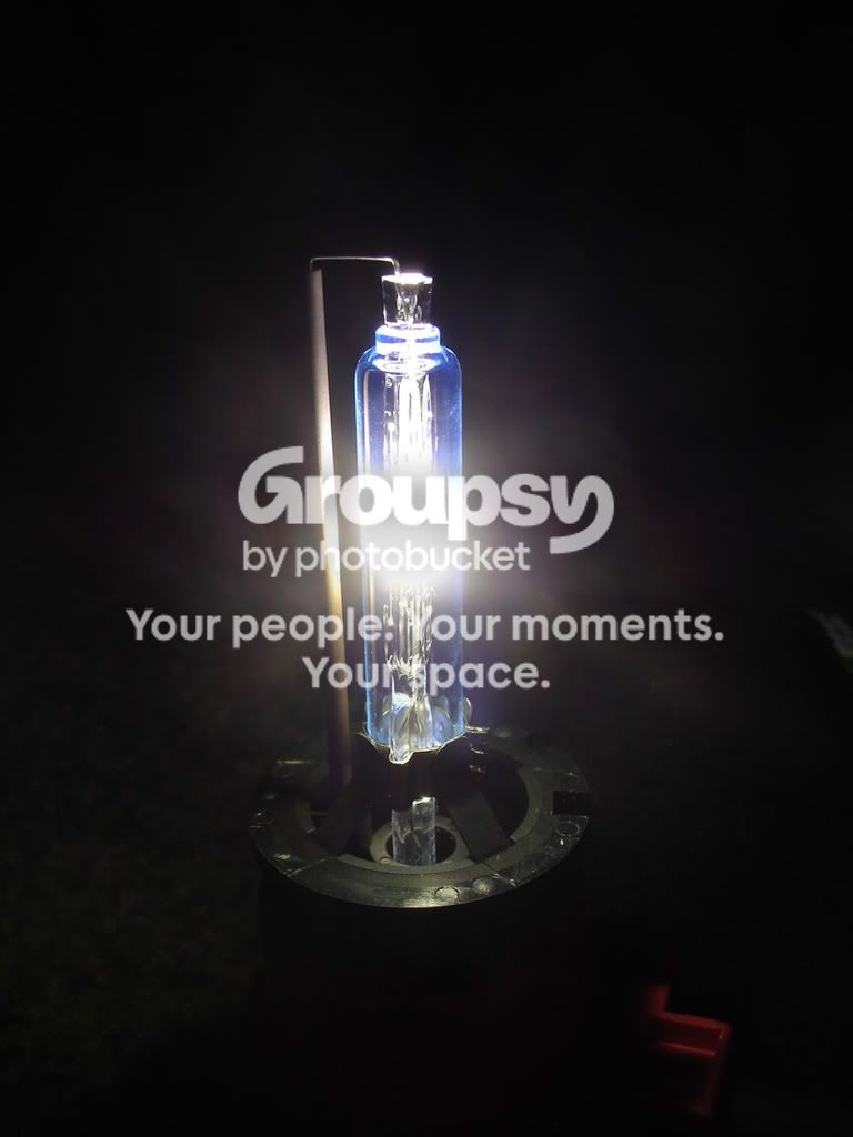

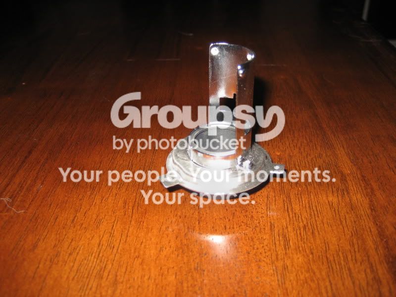

Now would this be because of the pre installed "casper shield"
Picture011-1.jpg~original

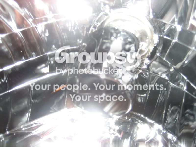

or the domed piece in the middle of the headlight housing
Picture016-1.jpg~original

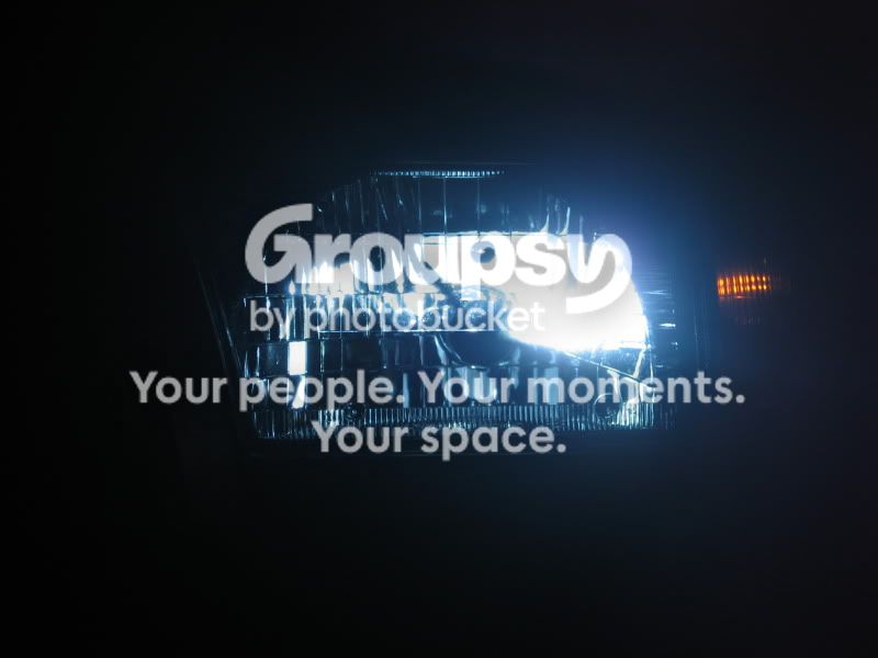

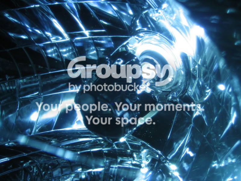

Just for s*its and giggles, here is a pic from the inside....
Picture012-1.jpg~original
There is a stop sign to the middle right of the picture which is like 9 houses down, which I think is really good light output (granted I need to align the lights better....)

remember that the bottom of the light will reflect light upwards, so if you remove the shield on the adapter piece you have, it will provide more upwards glare, and basically only light up trees, and bridges you are driving under.
Hmmmm...With that being said, would "trimming" the interior reflector make any difference on the lower light output....Seems like I am winning a no win battle here with the HID's in regards to beam patters until I do projectors.....

I did check the 3 prongs, and they are good. Actually that is the only way that I can really make sure the lights are in since that glare shield has a twist lock in there to secure the HID bulb....
And no the camera did not distort the pics from the inside. That is actually what they look like. :(
Ok, decided to take off one of those shields to see what happened. It did fill in the bottom of the light..
Picture025.jpg~original
But didn't really affect the beam pattern too much...

I'm not certain, but I think this might affect the light output that I am seeing on the road with this pic (terrible beam pattern on road)

I would blame the aftermarket housings for the scattered light output. Probably wasn't evident with the halogen bulbs, because of the lower light output, but now with the HIDs it's more radical.

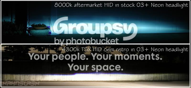

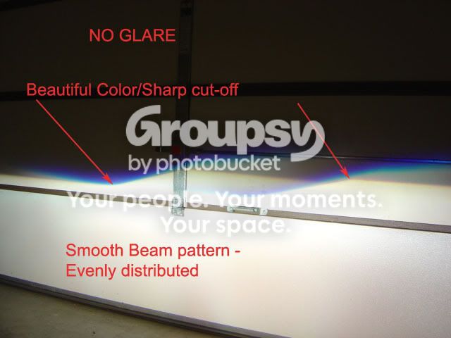

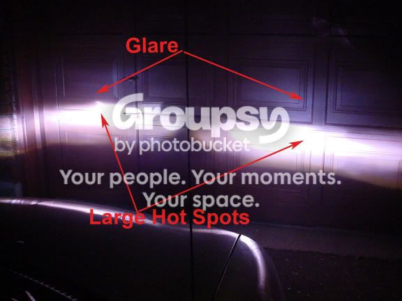

Here is a pic of the differences between PNP and OE HID.
thetruth.jpg~original
HID20001_copy.jpg~original
hid_011copy.jpg~original
I know those pics are hard to believe, but when you attempt to adapt a new technology into an old one, in this case the results will always be negative. Some people only want HID lights for the distinct color, others want the signature flicker that OE HID's give off, that attracts your eyes to them in the first place.

It comes from the cutoff, not the light beneath the cutoff. PNP bulbs try to replicate 1 of the colors in the prism of the cutoff with a higher kelvin rating. Unfortunately, the higher you go in the Kelvin scale, the lower in lumens. (actual light output) So when people talk about "Cool blue/purple xenon light" they are only referring to the light they see flicker in the cutoff, not the actual bulbs light, which is yellowish white as seen in the picture above below the cutoff line.

"When I look directly at my PNP's, they are brighter than your OE HID projectors, doesn't that mean they are better?"
Let me clear up this common myth, with something called useable light. The design of a halogen reflector/projector is to disperse light across a broad range in height in front of the vehicle due to halogen having such a weak output. When you use PNP bulbs in a halogen application, you get the extra power in lumens from the bulb now thrown all over the place, the sky, the side, anywhere but where you need it, on the ground in front of you. An OE HID projector will provide you with that!
