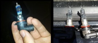

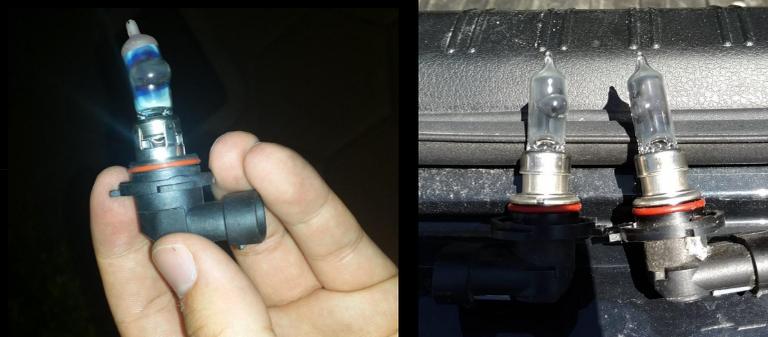

i'm seeing a few photos of these that have been put into the wrong housing all with bubbled sides, it looks like heat is an issue

i've found photos of the bulbs themselves melted, that's why i asked for first-hand experience to make sure the high-beam housing wouldn't melt.
look at the photos in the amazon reviews:

Usually that sort of thing happens when the installer doesn’t clean the oil off the glass. I get a clean paper towel and generously wipe down with rubbing alcohol before installing any bulb. Insert the bulb carefully not to touch any part of your car either. If you do then wipe down again with more alcohol. Avoid using thethe Side of the paper towel which make contact with your hands to wipe. Yes you can use gloves as well but some people get their gloves all greasy from their hands just trying to put turn gloves on. Extreme yes. But if you wanna do it right then go these length. **** I hate postings shit on my phone.
