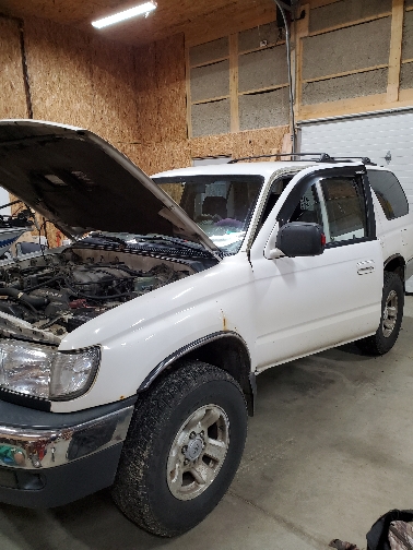

Hey everyone!! I put LED head light bulbs in my wife's 99 4runner. About a month later the indicator light on the dash for the high beam quit working. I pulled the dash and the bulb is good. I even tried the cluster out of a parts 4runner and still not work. Where do I look next?? Any help would greatly appreciated!!
