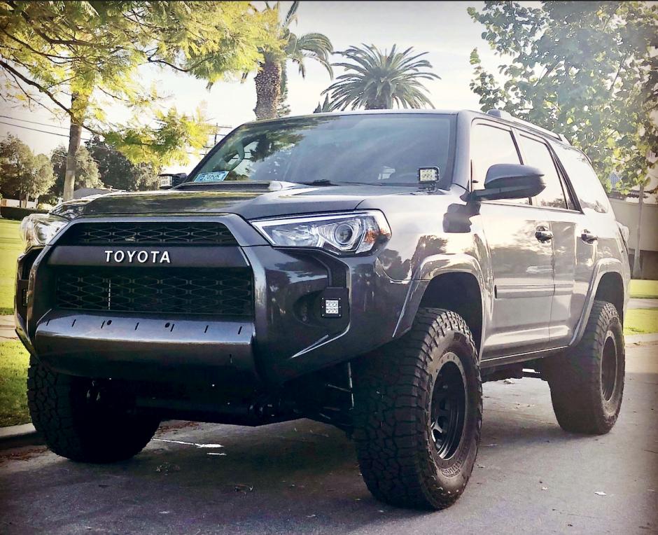

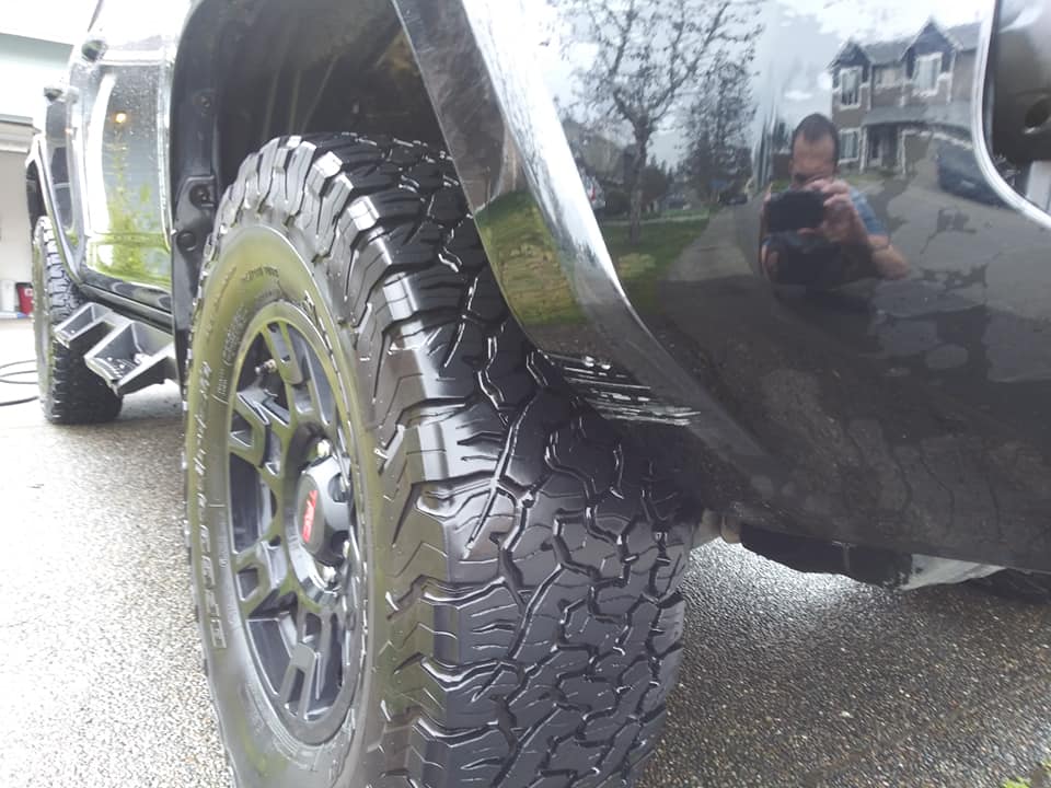

cut it. Luckily the fender liner is rigid enough that it doesn't flap back into the wheel well.

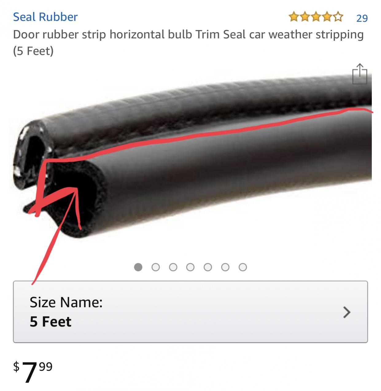

This is what you need from Amazon. It’s door weather strip, and you can pinch it tight against the fender cut. I cut off the excess rubber to clean it up.

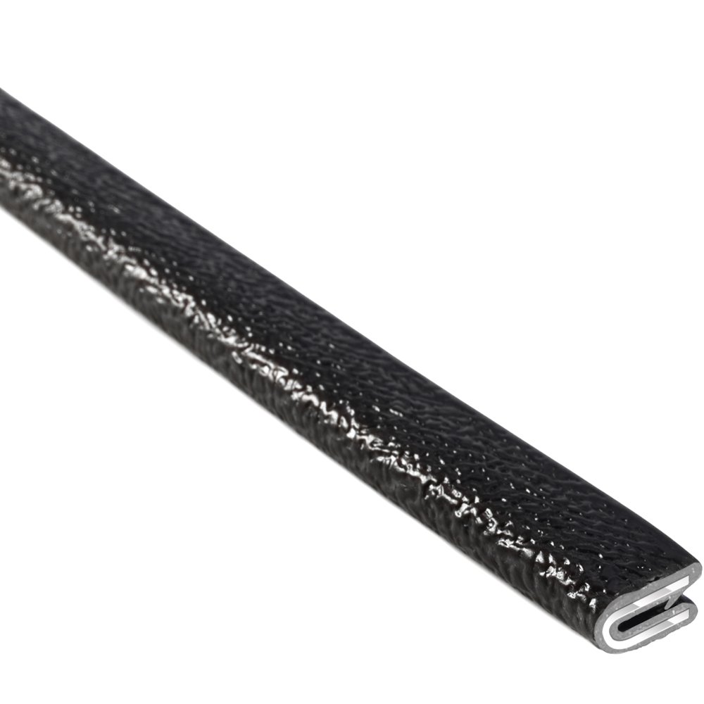

Just FYI; you can buy edge trim without the rubber seal on it. Usually the ones with the rubber seal are for door edges. It comes in a bunch of sizes, shapes, textures, and colors. I used one of the profiles with rubber seal edge on a couple doors on my camp trailer.
Trim-lok is a popular brand on Amazon, but it's a bit more expensive than some off brands.

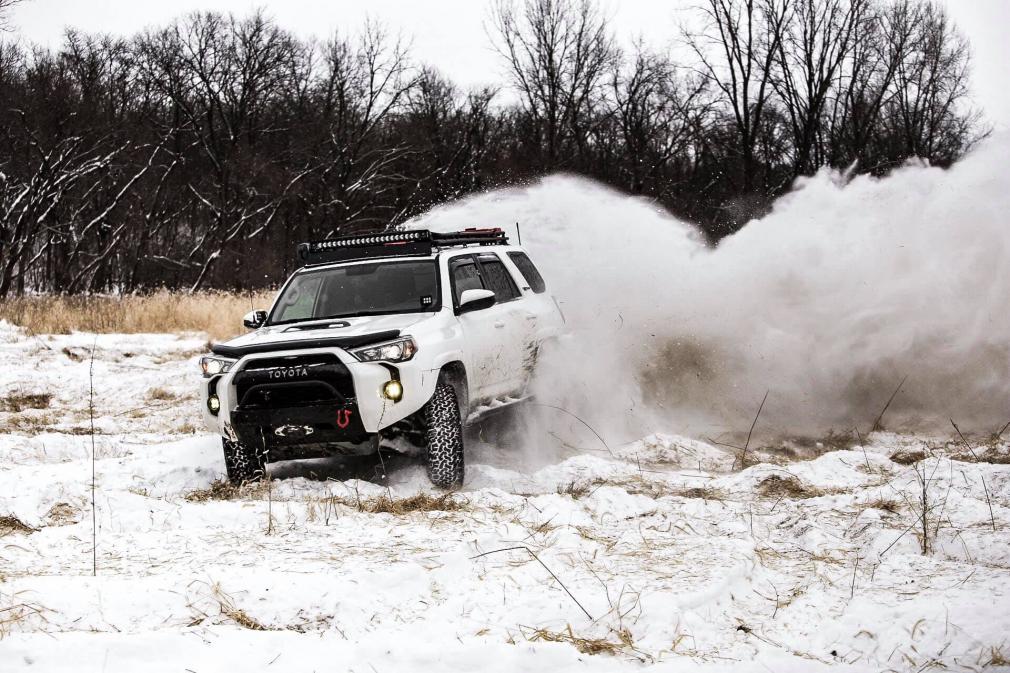

Bonus action shot:
