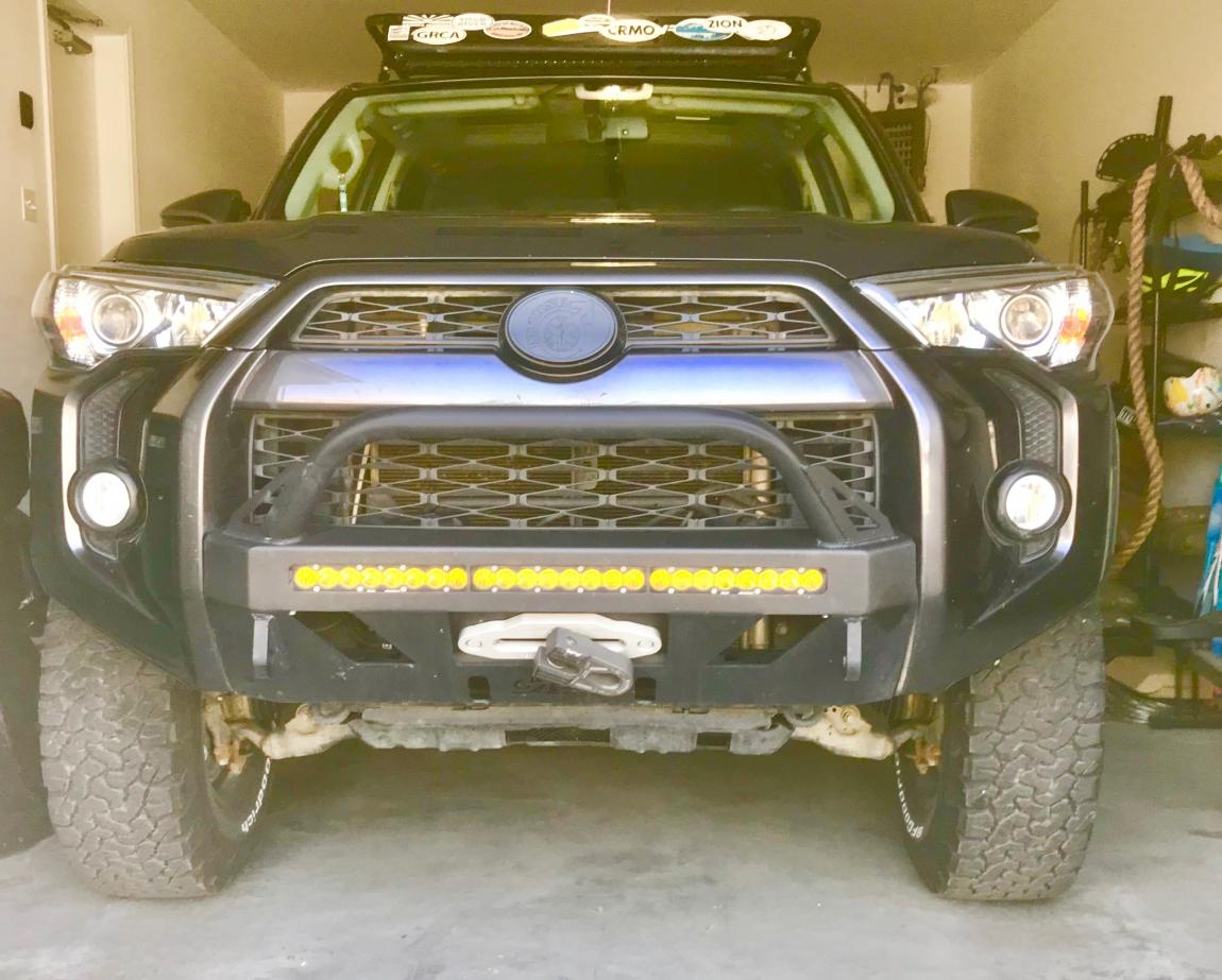

has anyone figured out any type of bracket for use with other brands. im very happy with my WARN winch mount. the bull bar sticks out further, ive had to push cows before. its cheaper and the winch mount is flat where the SSO is angled and I guess that's kinda a difference but marginal. mainly I bought it for the WARN name. anyway I want these now. picture from after last offroad trip. plus im about to get wheel spacers.
Hey Brad, what sort of thing did you hit that struck your bumper in that way? Just curious how that all went down. Thanks, man.

not really sure just some rocks that scraped (I imagine) from some of the ditches I went through. also bent my steps (need rocksliders) and bent a piece of my new magnaflow exhaust.

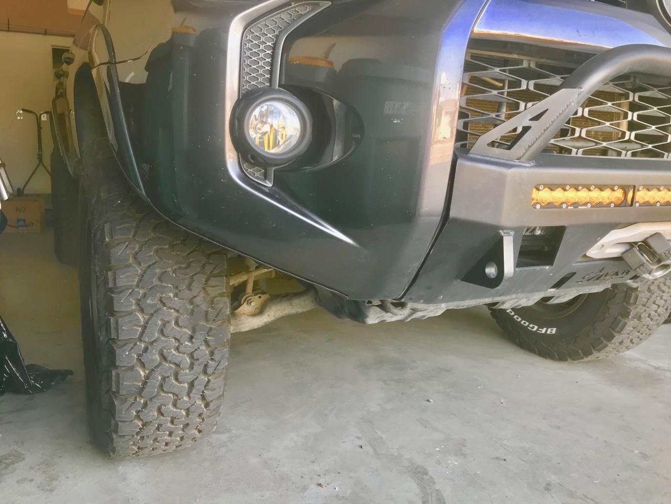

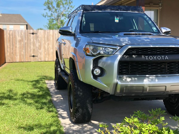

Did a quick high clearance mod/cut. I think I have to adjust the inner fender to make it a little tighter and cleaner.
Happy with the results. I basically taped the lower fender line, then cut at the bottom of the tape, to give it a little more depth.

Used some painters tape to make the line and the roll itself to form the curve cut. I went aggressive and I like it. Despite clean cuts I think it kinda looks like hot garbage from the profile view but w.e. Need to get a proper bumper eventually anyways. Definitely loses the soccer mom feel I get from the front plastics.

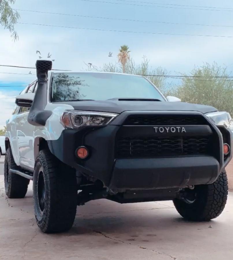

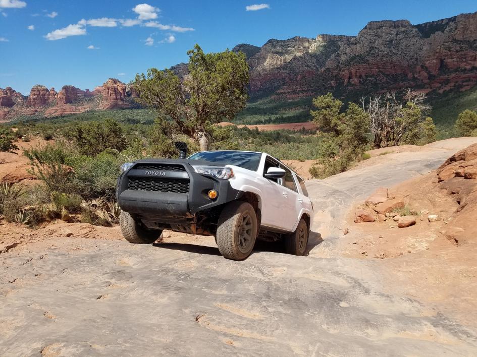

265 and high fender cut
Hey guys. I wanted to do a high fender cut but my size tires are not as big as what other guys have on their rigs. Does anyone have any pictures of their rig with a high fender cut and 265/70/17?
Didn't take many photos when I had stock size tires with the cut (switched out to 285 shortly after making the cut).
Here's one with 265 falkens (31.9in tire)
The photos of my truck on the second page are on stock tires (265) and suspension. Hope that helps.

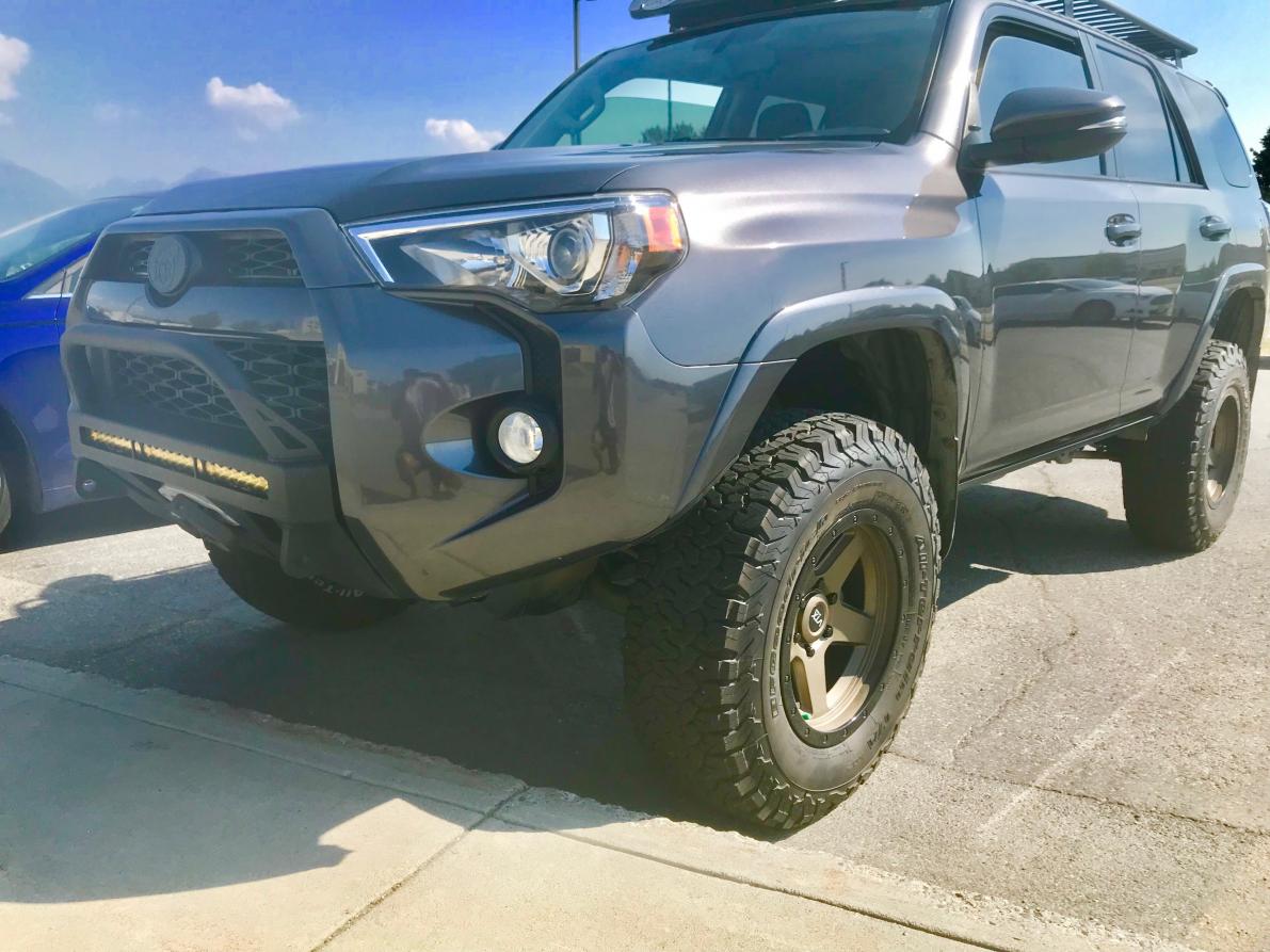

Lifted and 33’s meow. Still no edging.

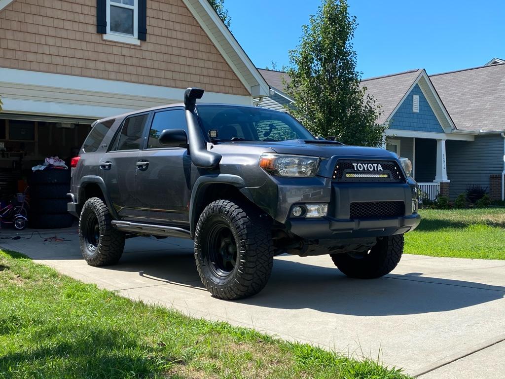

I wonder if anyone has tried this on the 2010-2013 front end (and I wonder if I’m about to be the first). I almost ripped my front bumper off on a gnarly trail last year so a few of the clips are shot, and some other trail damage that I’m forgetting about caused the mounting tabs on the bottom to tear. I’m going full front bumper later this year after we move, so I figured I’d have some fun with what I’ve got.
Oh well, got bored and knocked it out. Just need to clean up the edges a little more.
