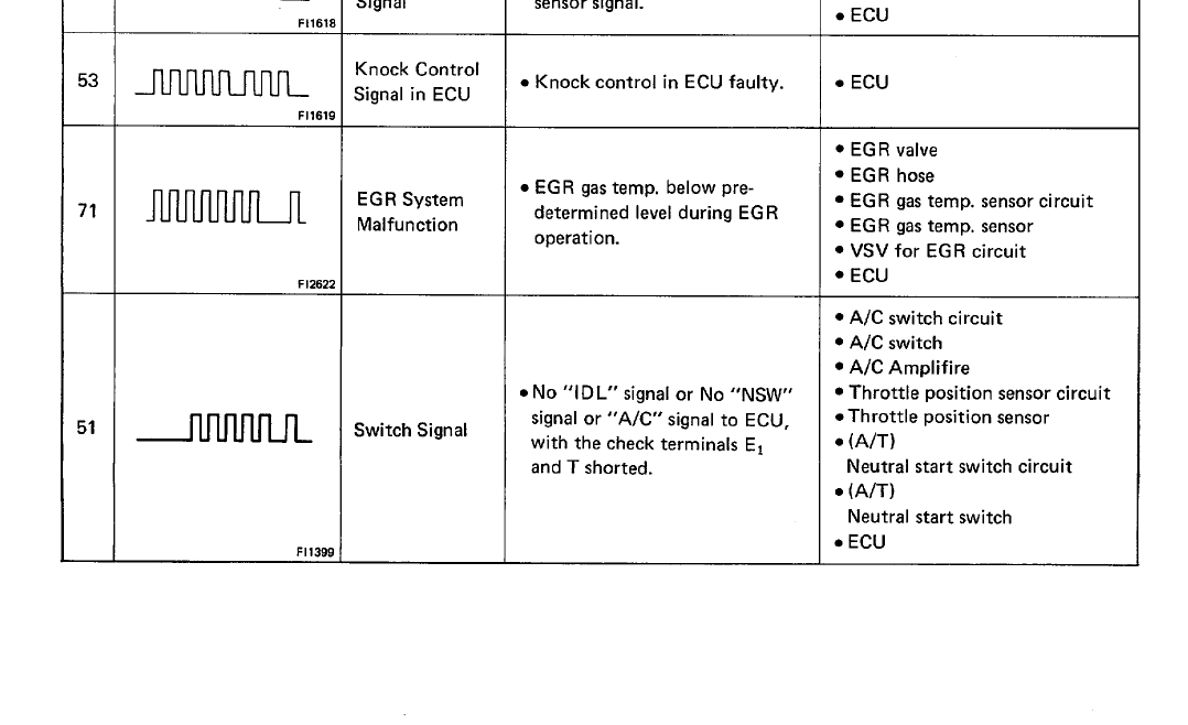

I checked for trouble codes, and it's throwing code 51. I know there are issues with the A/C that I haven't addressed just yet, I'm thinking this could be related to the code (issues with the A/C switch).

3. I think related to number 2 just because of the timing. See previous post, it's throwing code 51.
It's not throwing a CEL, but I checked for codes and got 51. Looked it up but it's only listed as switch signal, doesn't really tell me anything.
Yeah your gonna have to run through the trouble shooting for the Throttle Position Senor circuit. Your mechanical linkage issue will throw it off. Your gonna have to fix that before you can really expect the TPS to work correctly. Maybe this is what is making the Open Circuit Relay click and or the engine to die, but you won't really know till you get the linkage fixed.

Yeah your gonna have to run through the trouble shooting for the Throttle Position Senor circuit and the others listed if you have an A/T.
What others are listed? I'm looking on www.toublecodes.net and it only lists switch signal in the description. It's a manual btw.
41 Throttle Position Sensor signal.
42 Vehicle Speed Sensor signal.
43 Starter signal.
51 Switch signal.
52 Knock Sensor signal.
53 Knock Sensor signal.
54 Inter-cooler ECM signal.
So error code 51 could be A/C related? I know there are issues with the A/C. The line going into the cab has been cut and is missing. I've also discovered issues with the actual AC switch. Behind the glove box I found a jumper wire between two of the speed control wires. There are 4 speeds, let's say 1 is low and 4 is high. With the jumper wire connected, 1 doesn't work, 2 and 3 are reversed, and 4 works. IIRC with the jumper disconnected, only one of the speeds worked.

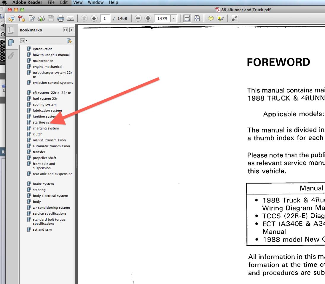

So I've tried using the FSM I have, but it's proven to be quite a challenge. It's in a PDF format, but it isn't searchable. I'm having to scroll through almost 1500 pages to find the appropriate section. Is there an easier way to do this?
Mine is not searchable either but it does have bookmarks on the side. Do you wanna try mine? It is a 85 4Runner FSM but it should be close.
