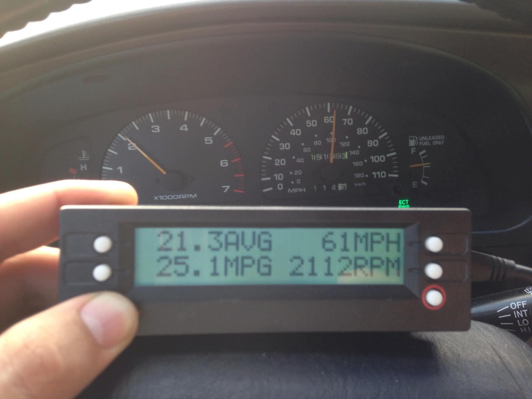

I have to update this one.
After cleaning the IAC I had a good idle but then I ran into the same problems. Even threw a code for the IAC. I replaced the IAC with oem and also the TPS.
I was getting 14-15mpg on the freeway before the maintenance. Today I was getting a 21mpg average to and from the beach. About a 20 mile trip through LA traffic. Crazy
