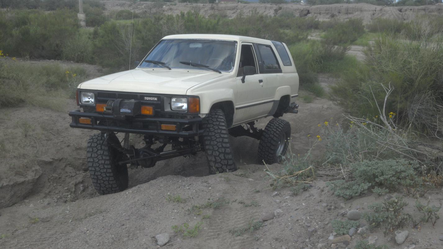

so I'm going to do high steer ,but whats better to use a drop pitman arm or to rotate the box and how far forward should i mount it ? and does anyone have a build thread

it's a 85 with a marlin 5" lift
You WILL need an IFS steering box for high steer, and the drop or flat pitman arm depends on how you mount the box for clearance with the leaf spring on compression, and with the frame when turning.
