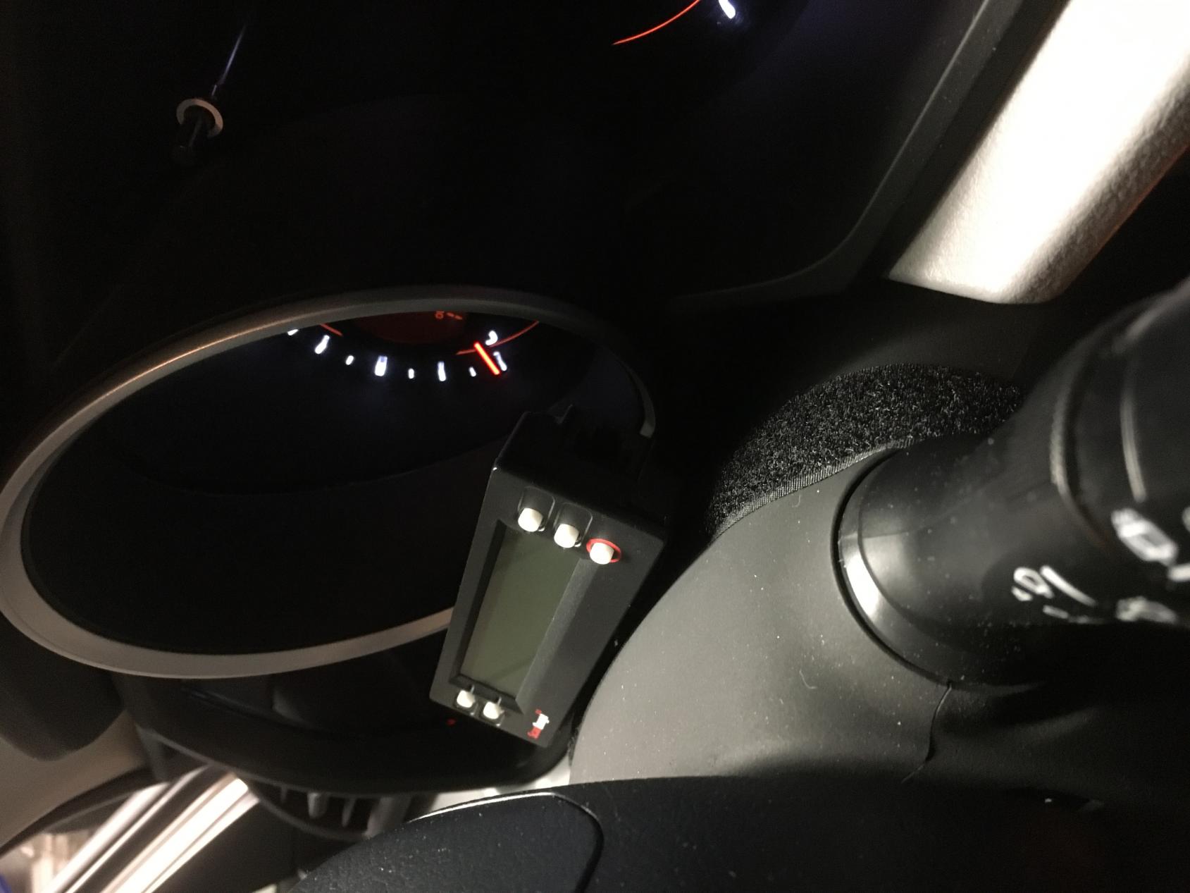

I only got my ScanGuage a few months ago. It takes a bit of time and reading to get stuff programmed and it’s pretty limited with only showing 4 gauges at once, but it’s still very much worth it.
At fast highway speeds, 75-90mph, the transmission cruises around 145-175° Depending on ambient. On long steep highway grades in warmer weather I’ve seen over 200° transmission temps but nothing over 210° yet. I always shift to 4th and usually keep it around 65mph on these. I would probably back-off if it gets any higher than that. I can’t even remember what temps I was seeing in 4L , I’ve only done a couple miles at a time so far with the gauge, but I guess it was unremarkable.
This is my jury rigged setup. I’m using a velcro strap around the steering column.

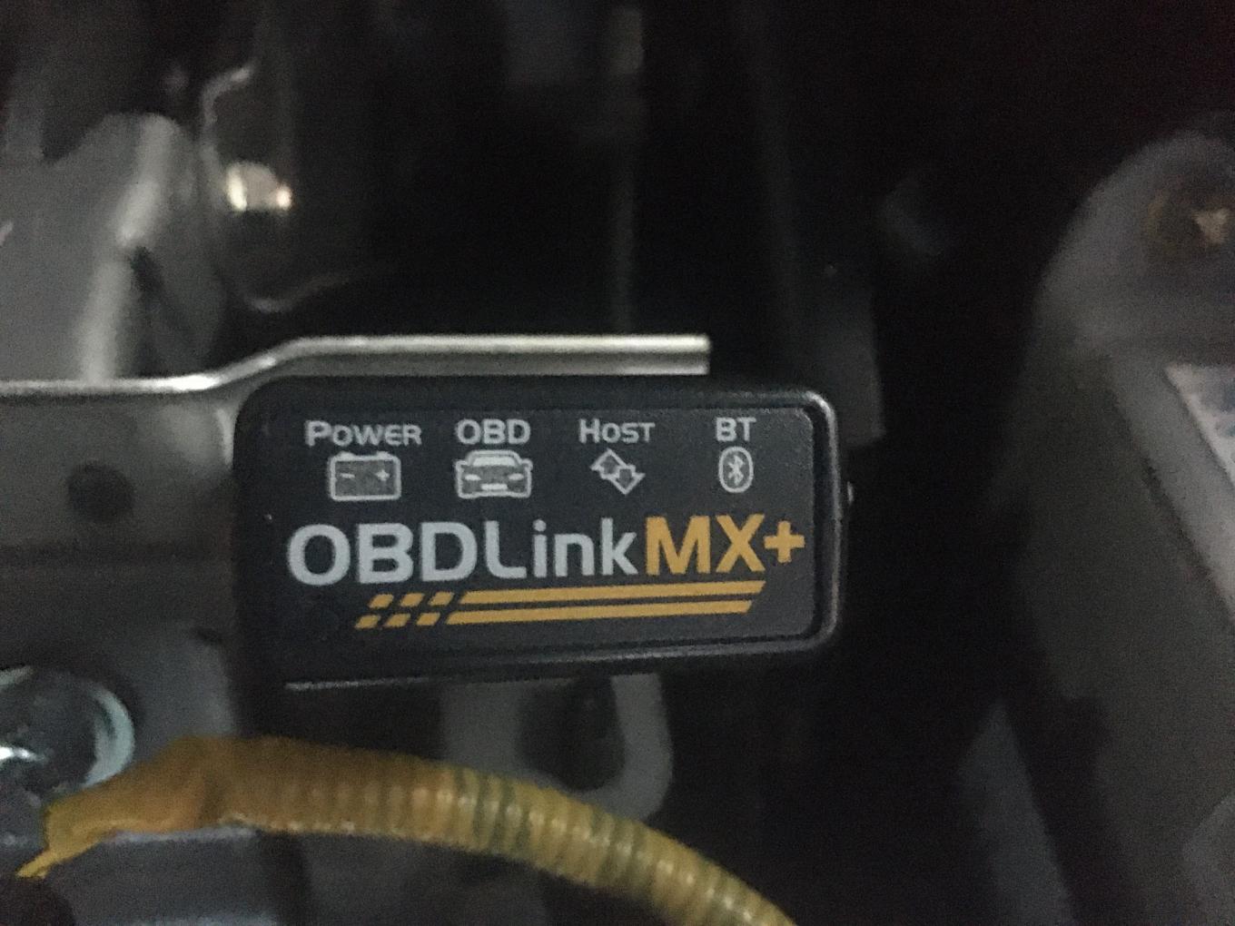

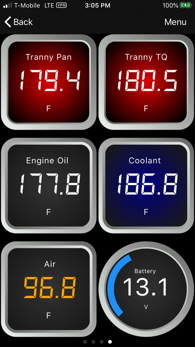

This is the scan tool I use and I love it, plugs in under the dash and then connects to your phone via Bluetooth. There’s probably 100 different gauges to choose from but these are the ones that I use.
I was out west in March and this thing is a life saver; climbing trails you can get all your temps at a glance.

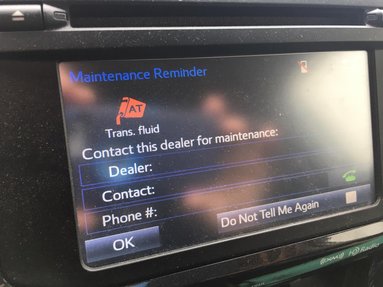

This is the only warning I’ve got related to my transmission, ironically this came up right after I hit the summit of a trail out west in Northern Arizona. It came up on my navigation screen with only 37k miles on my rig, no warning lights.
