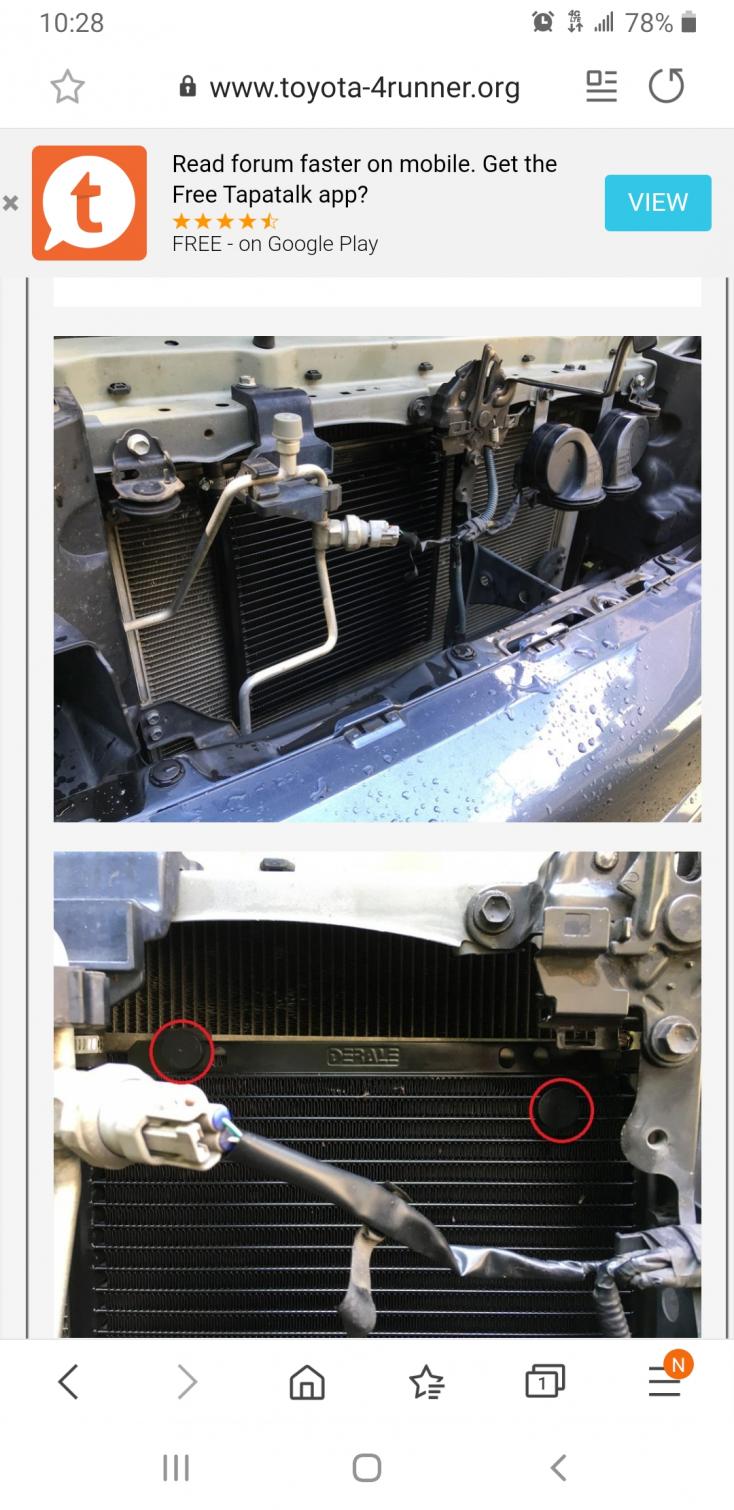

Going through the mountains and switchbacks at Bishop I upgraded to a Derale tranny cooler. Best thing I ever did for the transmission. Temps never saw more the 195 degrees in ambient temperatures of mid 90s. Seeing the temps steady in my Scanguage prove the money spent was worth it.
The transmission cooler:

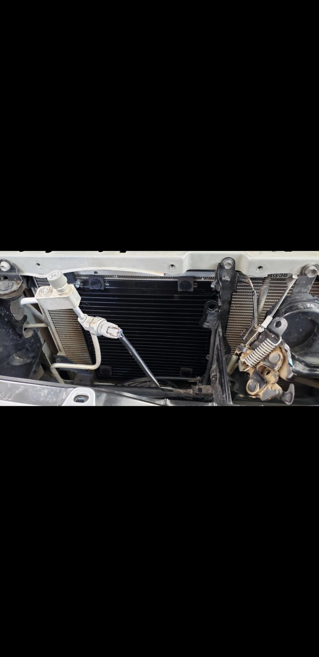

Before I had this i had to keep it in 4L to keep the temps down.
My setup:
Probably not the worst idea to change that cooked fluid sooner than later.

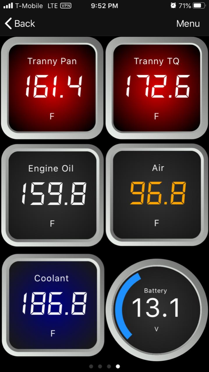

The general consensus has been that there is no oil temp or oil pressure sensor, for that matter, in the 4R…at least no sensor that can deliver data to the OBDII. Is this incorrect?
I’m getting a good reading on oil temps with the unit I use. Not sure the location of the sensor but I assume it’s post oil cooler.
I can not find a 5th generation engine oil temperature sensor. I searched on Camelback Toyota using the terms "temperature sensor" and "engine oil temperature sensor". I also searched with Google "5th generation 4runner engine oil temperature sensor" and didn't find anything.
Your OBDLink MX+ is showing engine oil temperature 177.8 F which is too low if the engine is fully warmed up. Oil temperature leaving the engine and entering a cooler should be above 212, ideally 220-230 F to evaporate condensation in the crankcase. Your oil temperature is also less than coolant temperature, 186.8 F, which doesn't make sense if this is oil temperature exiting an oil/coolant heat exchanger. Why would Toyota measure coolant or oil temperature at the exit of a radiator or heat exchanger? When a technician wants to perform diagnostics, isn't it better to measure coolant and oil temperature exiting the engine block?
Have you observed an engine oil temperature reading in the 220 to 230 F range?

I bought OBDLink MX+. It took awhile to set up 4 dashboards that gives me continuous real time data on my iPhone 8+ to the following parameters: 2 transmission fluid temps, coolant temp, battery voltage, 4 catalyst temps, 2 oxygen sensor voltages, 2 long term fuel trims, 2 short term fuel trims, total number of DTCs, number of emission related DTCs, total number of all cylinders misfire count, number of trouble codes, evaporator fin thermistor temp, and 4 tire pressures.
I have scanned for DTCs and none were found. I haven't tried the data log, monitor or mapping features. I will load OBDLink software on my laptop when the weather is cooler.
When launching the app, one has to select a connection to a particular system, such as Network A (engine, steering, airbag, a/c, driveline, etc), Tire Pres Monitor, Network F (vehicle body), Telematics, Immobiliser, and Occupant Detection. I haven't tried using the last 4 features. Note, each network is separate, therefore, when looking at tire pressures, one cannot simultaneously view engine data because each network has a different control unit.
Overall, I like how the information is displayed and I wanted something easy to use. BlueDriver is another one to consider. Google search BlueDriver vs OBDLink MX+.

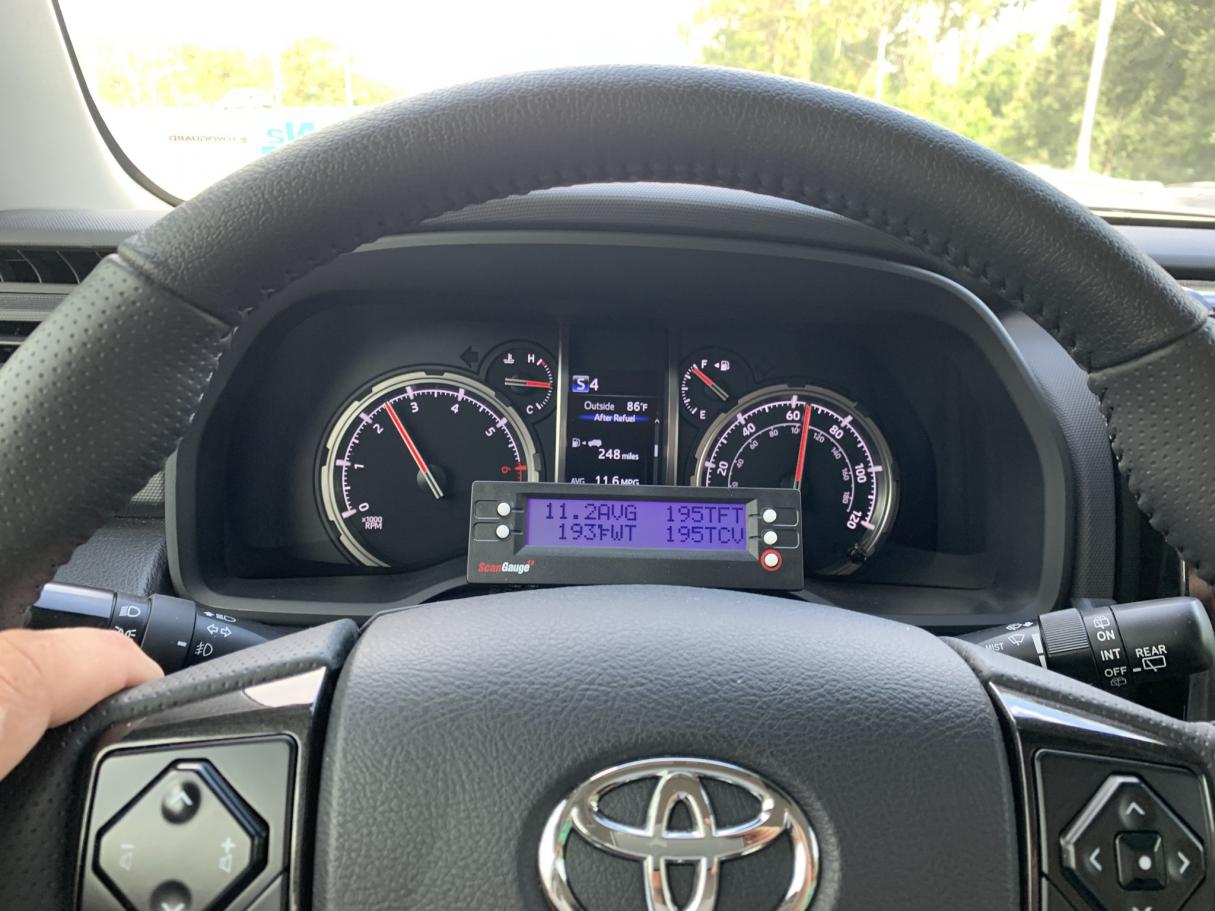

Love my Scangauge,this was pulling my camper ,flat ground

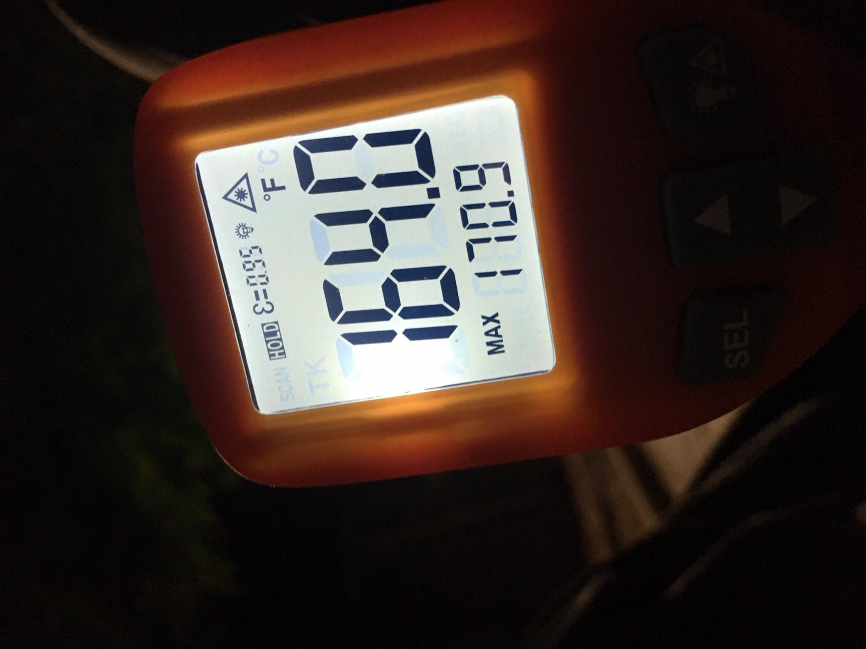

Only time I seen my oil temps get up in the 220-230’s is in the Rocky Mountains.
I know this little scanner isn’t the perfect fit for everyone’s application but it fit the bill for me. As for how or why the oil temps are the way they are I don’t know, all I know is when I cross reference the oil temps on the scanner with a thermal gun reading the oil pan it’s within an acceptable range for me.
The transmission pan temps are Spot On between the scanner and the thermal gun, the engine oil pan temps can be up to 5-20 degrees hotter than the scanner. But that’s still good info because it gives me a range.
Below are two pics from tonight.
