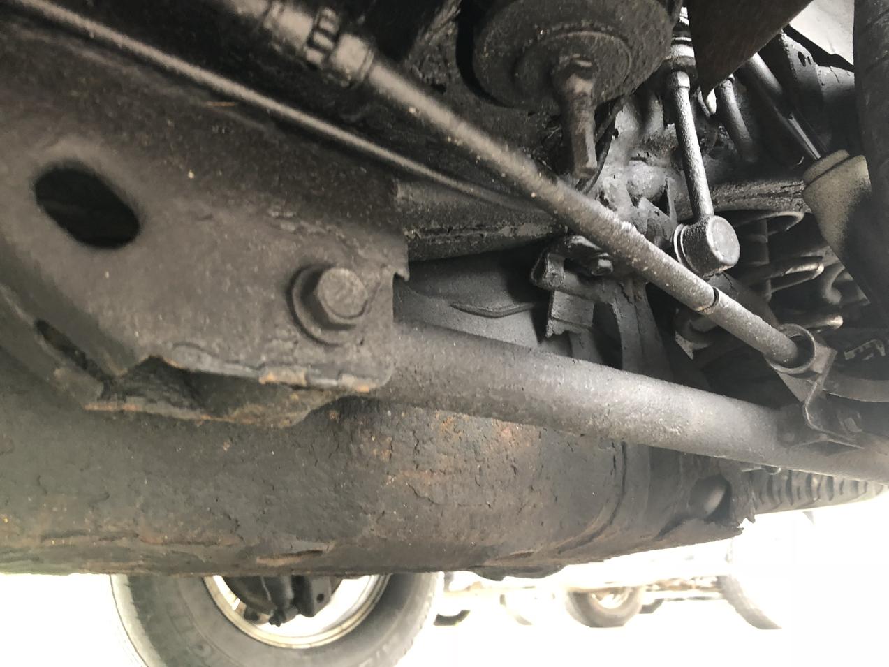

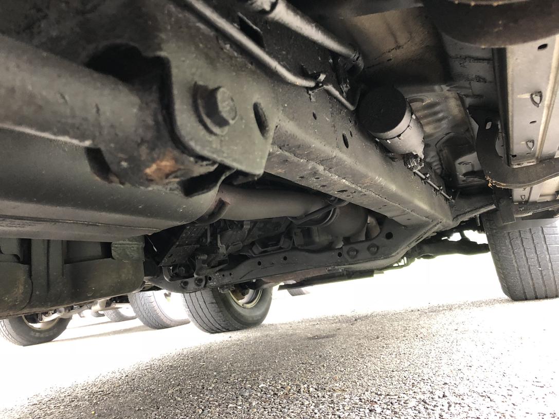

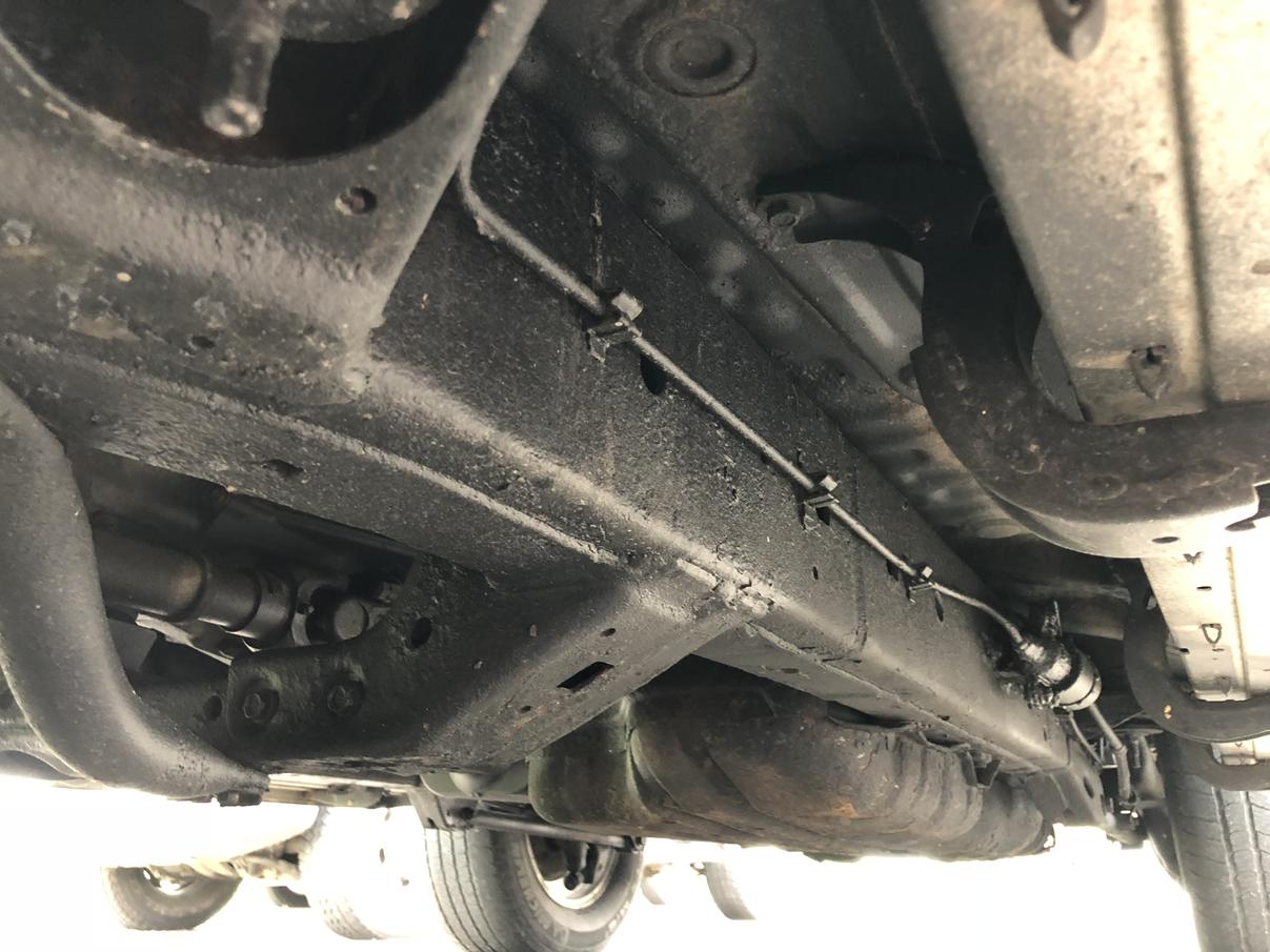

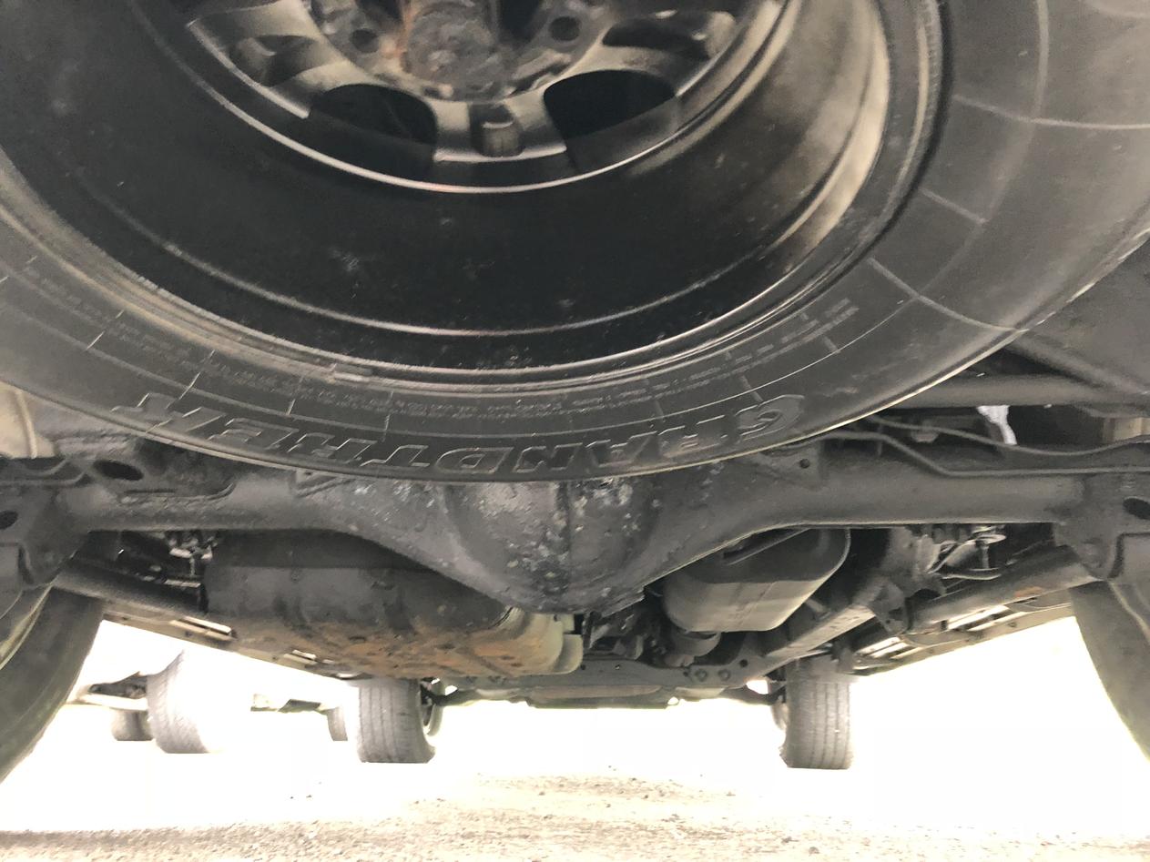

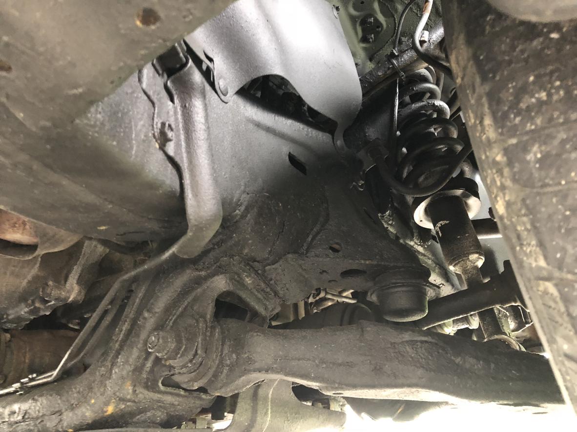

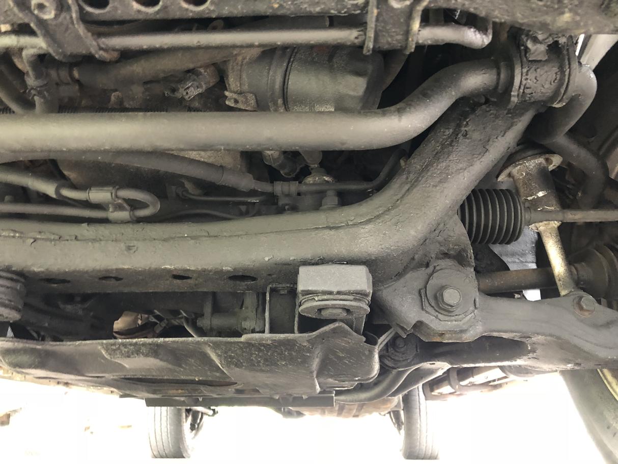

One thing I'm not clear on is why my posts have to be reviewed before they upload. Not clear on whether or not that's just because I am under a certain post count or what?
Regardless, here goes... let the flaming commence. Hopefully these pics will attach. This is a West Virginia car, V8 4wd, with less than 100k.

I'm no expert but I'll throw in my 2 cents. It looks to me like someone has applied undercoating to it fairly recently. Could be preventative maintenance or trying to hide a problem. From the pictures, it looks to be solid but it's hard to tell. One of the hardest affected areas is the radiator support so check there first. If you have someone you trust with a lift it might be a good idea to get it gone over with a fine tooth comb. Better to spend a few dollars now then waste thousands. Glad you are trying to be smart and cautious and let us know what you decide.
Appreciate the feedback.
This is an out of state purchase (~5hrs away from me, so will either drive up to pick it up or have it trailered down to Toyotechs here in Atlanta.)
I thought that might have been undercoating, but couldn't be sure. I've just been elated to see black rather than brown under these cars...
I'm scheduling a pre-purchase inspection with the Toyota dealership down the street from the dealer that has this. We'll see what they say.
