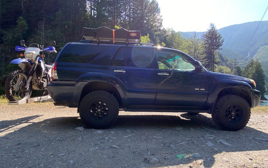

260k 2007
I have an 07 with 260k miles, have driven it across the country and back multiple times with a enduro motorcycle on the back. What a beast! unfortunatly
Its calling for some repairs..
Still runs pretty good but will need the following based on inspection
General Maintenance Concern
Todays Concern
*Taxes not included
Timing Chain & Gears
$2,967.67*
Cooling System Fluid Exchange
$119.95*
Fuel Injection Flush Cleaning Service
$129.99*
Spark Plug(s)
$250.98*
PCV Valve / Hose
Remove and replace pcv valve and hose if needed.
$250.21*
Stabilizer Link / Kit
$571.64*[/I][/I]
Love the rig but...not sure if its worth it...Any thoughts?

Depends on what your financial situation is. You've listed just north of $4k in repairs, could you buy something you'd be equally happy with vs. putting the same $4k into your truck?
Also, if you're capable with a wrench, you could knock most of the stuff on the list and save a bucket of money in labor. And once the timing chain is serviced, you're good for another 300k.
Sidenote, why are they suggesting changing it now? Are you have issues? Seems a bit premature but that's just my opinion.

Pretty much as eleven14 says, can you do basic mechanics? That's about my level and I have done the coolant/spark plugs in this, and the PCV valve on another vehicle. It was a bolt-in part at the top of the engine, easy. You could do it at the same time as the spark plugs. As long as you are methodical and patient it really does look like a worse job than than it is, I promise!
That fuel injection thing sounds redundant to me, besides the occasional bottle of Redex at £5 I've never put any treatment in and never had a single fuel injector problem in any vehicle I've owned...
Start with the easy stuff, the guys on this forum are so helpful I'm sure they'll advise if you have any problems.

Is your truck showing a check engine light at all? How often do you change your oil? How is the engine running? any rough idle or hard starting?
I've read on this forum that the timing chain and gears are good for the lifetime of the engine with regular maintenance of changing the oil when it is due.
My 06 v6 has had oil changes every 5,000 miles with valvoline maxlife 5w-30 and toyota filter for the past 130k miles and mine runs like a top.
I think they are trying to scare you into buying a timing chain and gears that are not needed.
The stabilizer end links are bolt on and easy to change. Moog makes a set made in Japan that I installed 4 years ago and they are just fine.
Amazon.com: MOOG K90677 Stabilizer Bar Link : Automotive
Coolant is cheap. $30 a jug from Toyota. Get the pink coolant. Drain and fill radiator and burp out the air bubbles. again, easy to do. I've done this 4 times now on mine.
Spark plugs are easy as well. $60 for Iridium that I installed and took about 30 minutes with a long extension, 3/8 driver and spark plug socket and gapper.
Good luck!

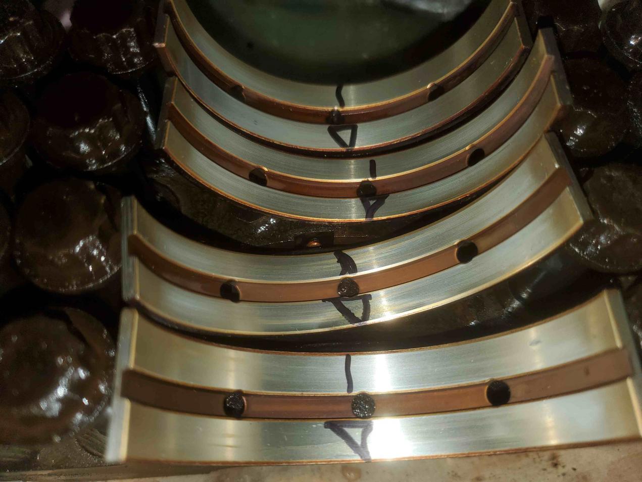

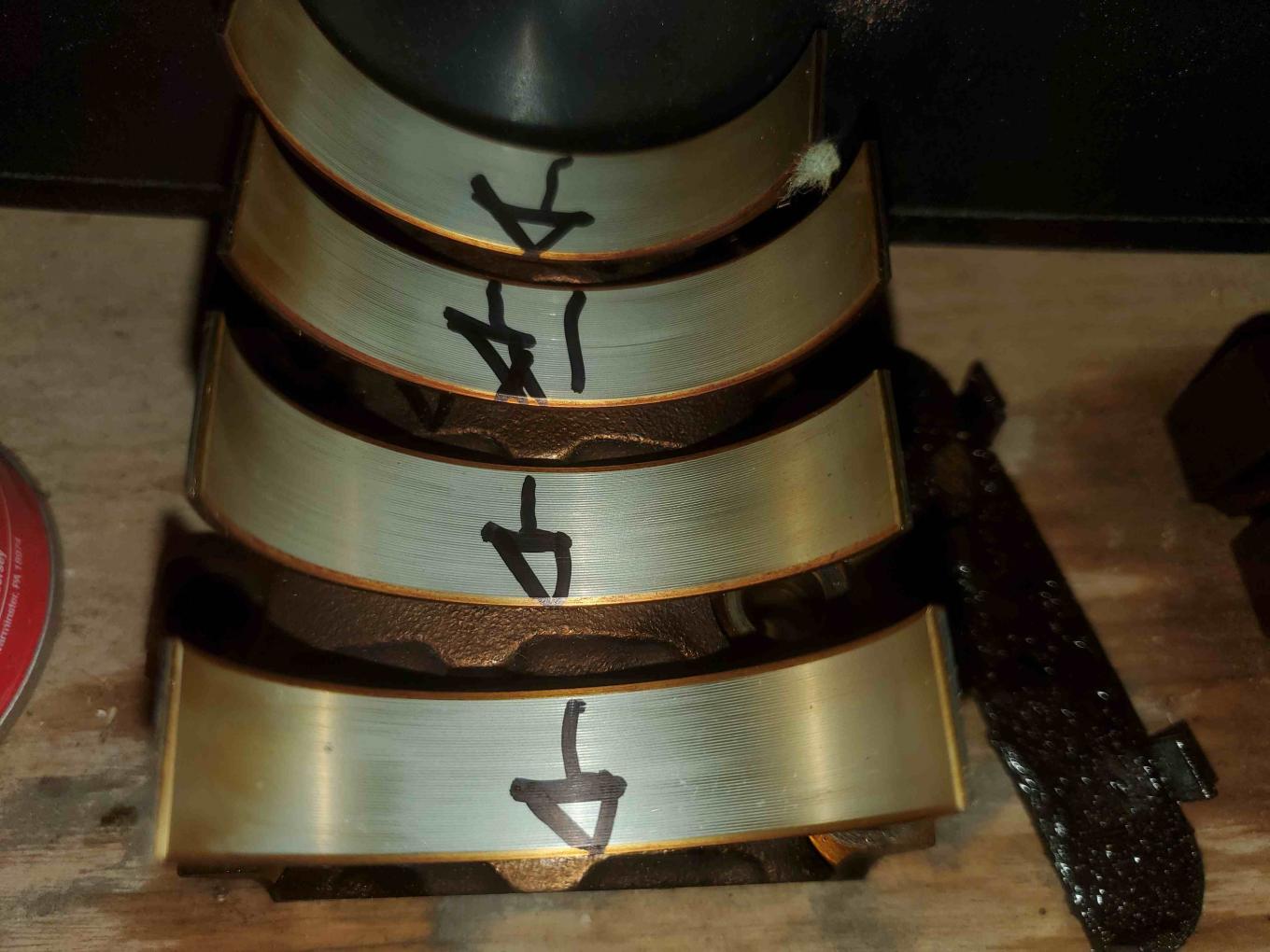

Original bearings
Here is a few pics of the main and rod bearings out of the 04 V6 i rebuilt from a wreck for my sons Runner. Impressive for 280K miles
