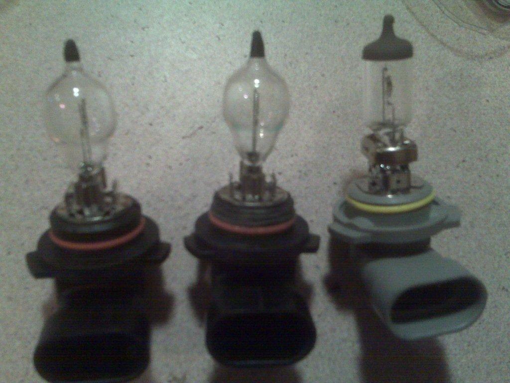

A Dremel made quick work of cutting down the one tab on each bulb to match the bulbs I took out. I had a real problem with the barrel of the base fitting into the low-beam reflectors, it jambed tight and wouldn't go in far enough. I ended up grinding down the plastic that was forward of the O-ring, to match the plastic of the bulbs that came out. First I carved with the Dremel, then hand filed, all very carefully. The bulb in the middle is modified, the left is unmodified, the right is the stock bulb. Sorry for the cellphone pics, but you get the idea. The high-beams bulbs are made the same, but they fit without a problem.

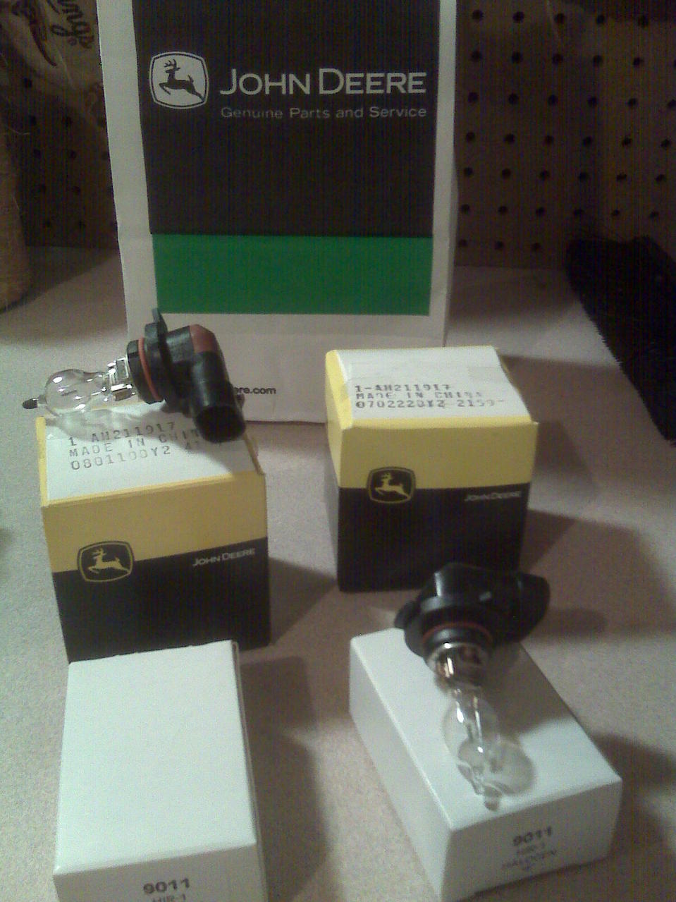

The low beams are Chinese-made Toshiba HIR2 from John Deere, $28.50 each. The high-beams are Japanese-made Toshiba HIR1 from CandlePower.

Here is some good info on trimming the tabs
HIR 9011 and 9012 bulbs are exactly identical in all dimensions to 9005 and 9006 bulbs, except for two areas, the second of wh

I put these bulbs in my older Land Cruiser, I'm not sure why the holes in my low-beam reflectors are so tight. I actually rubbed chrome off the plastic onto the bulb base, that's how I knew it was too tight.
