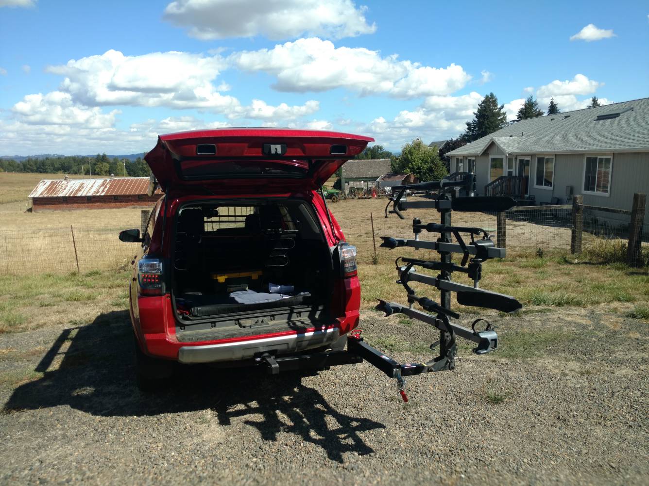

While we're on the subject, don't do this either. It's asking for trouble.

You can help the side to side / up down flex that can cause metal fatigue with turn buckles / chain to hitch safety chain eyes / front tie downs eyes. Pics on page 3 of this thread shows what I did front/ rear.
http://www.toyota-4runner.org/5th-gen-t4rs/213975-front-hitch-receiver-3.html
