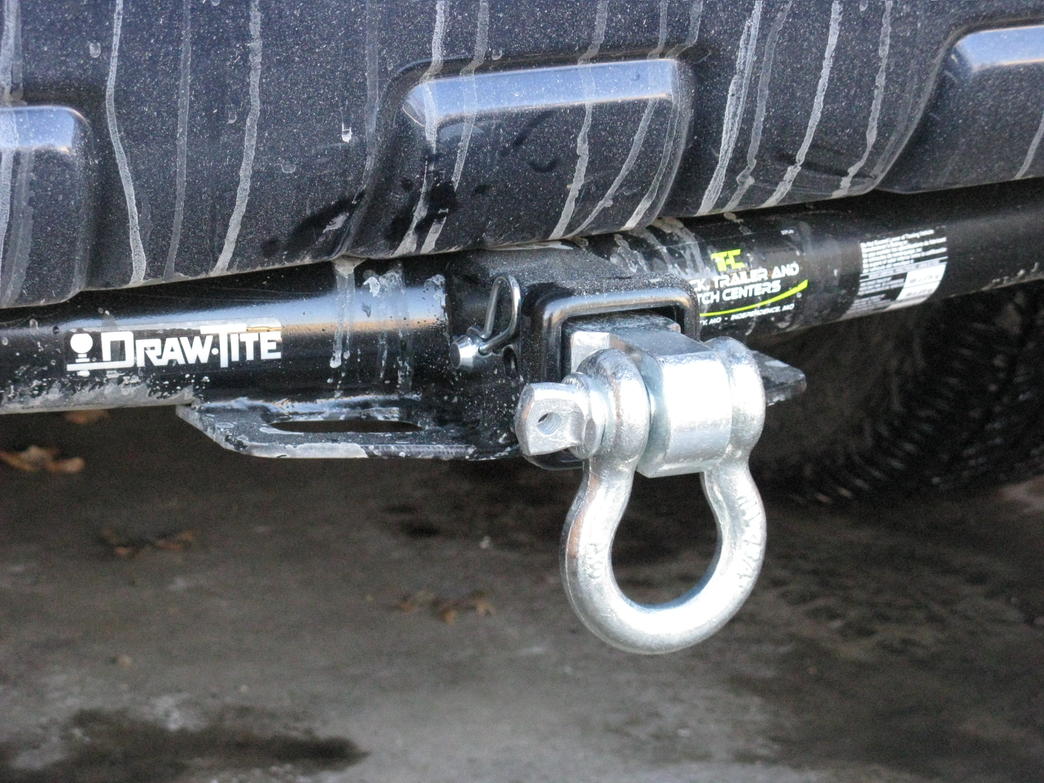

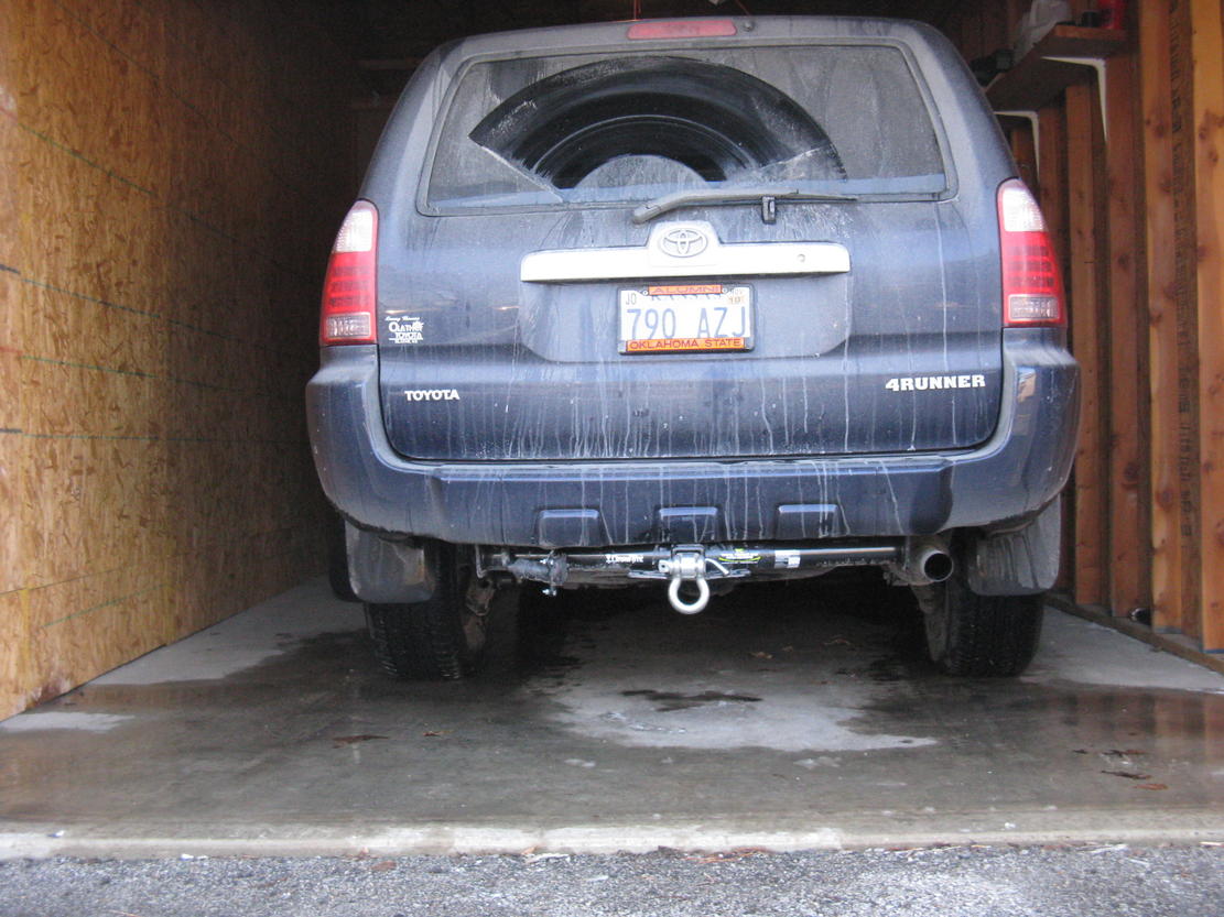

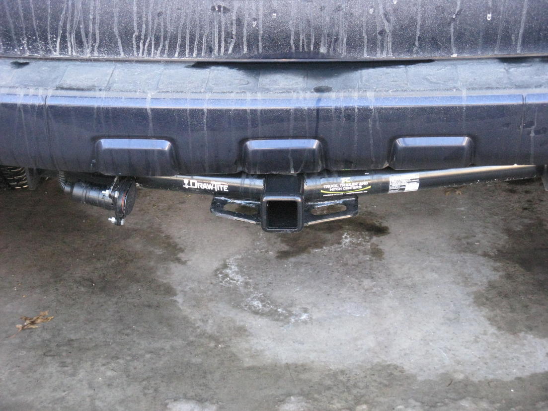

Draw-Tite Hitch and Shackle w/ Bracket Installed
Finally got the hitch installed at Truck, Trailer, and Hitch here in Kansas City.
Hitch Receiver:
Draw-Tite Class III - $219 + $35 Installation
Model # 75155
Shackle:
Bulldog Winch - $30 (I installed this one all by myself)
Model # 20037
9500 LB Working Load Limit (Or as Limited by Hitch Capacity)
Here are some pics:

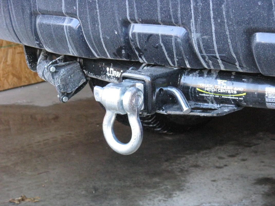

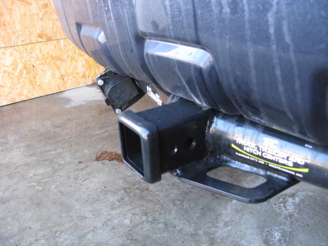

I like that the Hitch Receiver came with a bracket to relocate the light plug.
With Shackle In

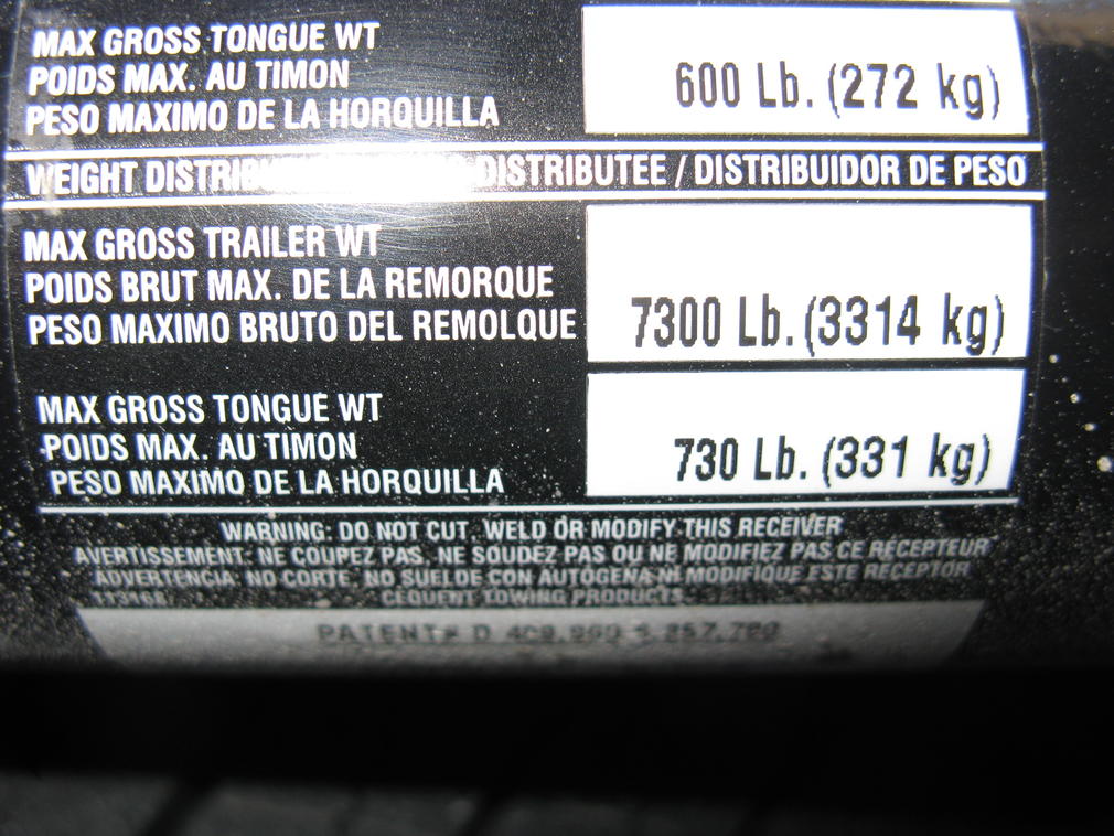

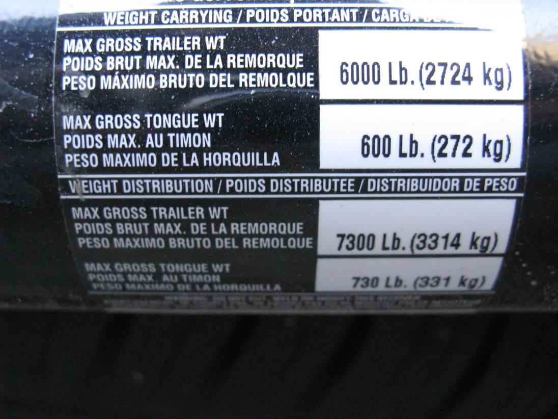

Looks good! What does the weight rating sticker on the hitch say? Your hitch looks identical to my Hidden Hitch.
:cheers:
What are the factory weight limits on a reciever hitch installed on V8 4x4? I know it's rated for 7k, I wonder if the hitch is rated for that?

Thanks! That's the same as I have. Every now and then someone with a V6 wants to upgrade to this hitch for a motorcycle carrier or to use spring-bars. The OE V6 hitch is rated for less.

Looks good, but a suggestion....
I would get some waterproof tape and seal the cable sleeve and back side of the wire harness plug. Where it is located, which is the same as mine, will allow moisture to be sprayed on it everytime it is wet. I can see evidence of that in your pics. Barely one year after I installed my new hitch and relocated the harness plug, I started having light problems with my trailers. When I took apart the plug assy., I found moisture had found its way into the back of the harness and caused corrosion damage. I had to rewire the harness to correct the problem.
Thanks, and good suggestion! Any recommended waterproof tape that will hold up?
I used some self sealing electrical tape I have, it works well, but it will deteriorate over time, so I intend to inspect and replace it when needed. You might want to try a marine supply store to see if they have anything that will work.
